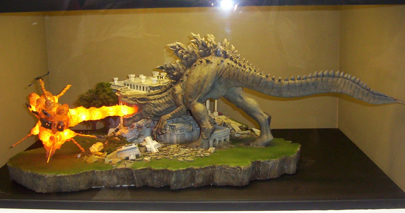

An alternative to the much used steel wool...
There was a write up in the complete technique in Amazing Figure Modeler #40 - and it is amazing.  I have used the basic technique both in the lit form and the unlit form a few times.
The gist of it is like so...
Use a can of spray foam, and a rough armature of your parts attached to wires and stuff.  In the above photo, the monster is blasting a helicopter (Marine 1 IIRC) and it is exploding.  For just a smoke cloud, you won't need any debris.  If you are doing damage markers - you can add in things like tank turrets, tires, helmets...or whatever seems right.
With the foam - spray it along the armature building up as appropriate for it's intended use.  It will be naturally billowy, like smoke or a roaring fire.
Let fully cure and paint like any other plastic (the urethane foam is self skinning and the skin is smooth).
For the extra points on the project...make a mold of your smoke plume prior to painting.  Rotocast it using a clear resin...you can tint the resin some using appropriate dyes for your resin of choice.  Rotocasting will leave you with a hollow casting of the mold, which lets you get really funky.
Use clear paints to paint the flame, use opaque paints for painting the smoke areas as well as the flying debris.  Once you are happy with the coloring - use a LED light rope and slide it up into the hollow cavity.  Light it up...make any adjustments to your paint job that you need.  Mount the completed plume to a base (either an actual base, a vehicle, building or other blown up object).
