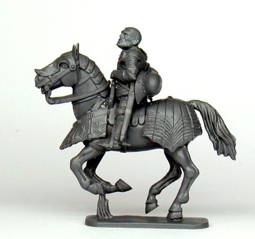

First up is Count Otto Von Spargel, Hanseatic mercenary Kommandant! Jimbibbly kindly sent me some left over GW Empire accessories. Most of the weapons are too outsized to look real, but one or two of the heads are really too good not to use... Otto wears all the latest German-style harness, with his Sallet slung from his belt...

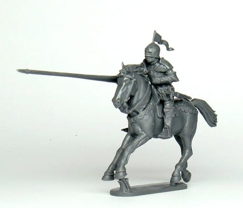

Next, a charging knight, extending his reach with the lance to spike. I'm not massively keen on the little flag on his bonce, as I think these are rather distinctively Burgundian, and I'm not doing Burgundians, but what the hell... He is (shock horror) in all respects a standard build straight from the MMAA box, with the exception of his sword from the WOTR command frame.

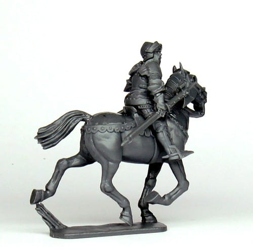

And thirdly, another man at arms. Again largely built from the MMAA box, although using one of the poleaxe arms from the WOTR command frame. I appreciate of course, that the poleaxe was the knightly weapon of choice for combat on foot and not used from horseback. But then, given the propensity for the gentry to saddle up and race off after their fleeing foes in the aftermath of a battle, I see no reason why a few would not still be clutching their poleaxes as they mount up and exhort their comrades to join the pursuit... I doubt there was always a squire standing by with a lance ready ;)
On the horse, I've also shaved off the cruciform trappings over the rump - just to provide a bit of variety in appearance really. A generous slathering of poly cement smooths and covers any last vestiges...
