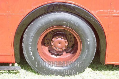

I know it's easy to use toy tyres in the models we make, but there must be a way to make ones!!! ???
 I'm looking for something specific. I know ramshackle games do something similar to what I need, but I'd just like to know if anybody's made their own? It's easy enough to cut plastic card circles, but then that looks too square!! This is what id like to reproduce...
My plan is, of I can make these, then I'll make the rest of my wee idea for an add-on to one of my other projects.
Please help!!!! :'(

Probably not the advice you're after but I would laser cut the basic profile including the little dinks and then set it up on a lathe to get the desired curvature.
Never tried one by hand before. I would imagine it would be a bit of a sod  :?

If you look at the thread by Brent from Company B on his build for the master of his 1/56 Bearcat, it has a sort of mini tutorial on tyre making.
Option B might be the old Military Modelling 1978 Annual approach. Find a suitable sized tyre from an existing kit or toy, make a plasticine mould and cast in resin.

I built the master for this Company B Dodge.  I "reinvented the wheel" so to speak and started with a round ball of green stuff, pressed it flat into a disc shape.  Then I used a series of concave or convex "punches" to form the basic rim shape.  When the putty cured, I made a quick jig (like a crude lathe) where I could turn the wheel on its axis -to scribe rim details and square off the tread surface.  Finally I notched in the tread with a file.  Just one wheel, then multiple casts were made of the single wheel.  The side not visible in this photo has the lug-nut details.

Ramirez Noname-Its actually 1:48 I'm looking for. I reckon with the scale taken into account they should be about 25-28mm.
JOHNNYTODD-Thats fantastic! I'll mabye see if I can set something up using a hand drill instead of a lathe.
Do you have a dremel? Set up correctly they can make reasonable lathes.

I need to get that tire thread archived.  I moved servers, so I have the images.  Just need to re-link them.  Using plastic strip is quite easy, and you can knock out several styles in a day or so.
