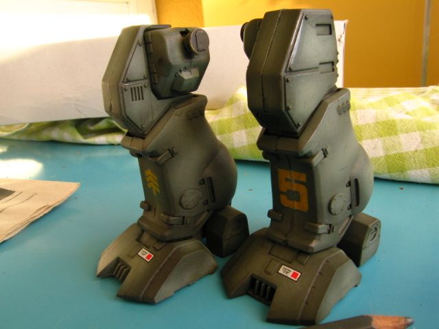

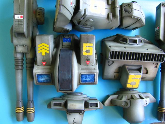

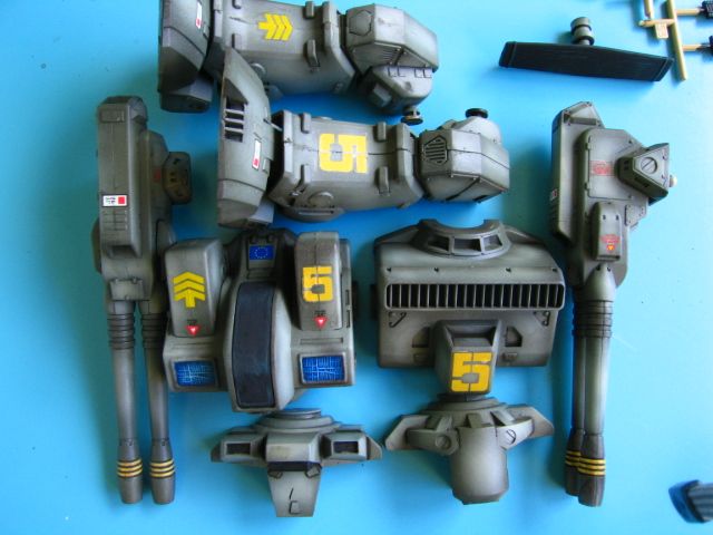

Here's something new:seeing Dr. Mathias excellent Step by Step Painting made me realise how much i love wip/Process Photos  ;D

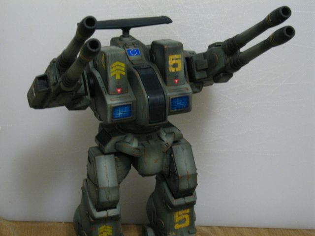

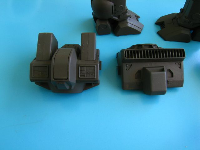

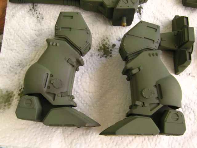

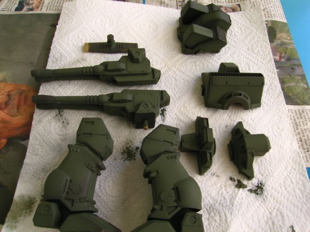

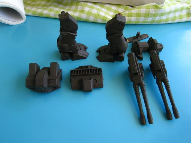

Not that any of you fine Chaps would need my Painting Tips but here's a quick Tutorial of how i paint a Mech relatively easily  ::)
GW Charodon Granite Primer
Vallejo US Army Green Basecoat
mixed Vallejo Silver Grey with the US Army Green for the Shading,i've applied 3-4 thin Layers.
forgot to take a Pic of the next Step  ::) After the Shading i've applied a Filter to blend the colors.The Filter is simply made of the Basecoat Army Green+ Secret Weapon Armour Wash mixed with Vallejo Glaze Medium and most importantly distilled Water  ;) The Model is now Green again  lol,Added Decals and painted some Details,the Cockpit,Headlights etc
End of Part 1,hope you enjoyed it. I'm posting the Weathering and Finishing tonite  :)

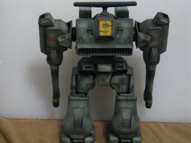

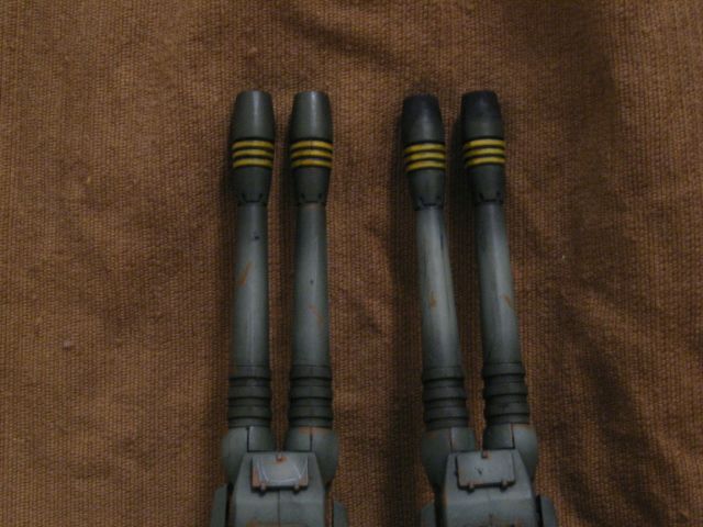

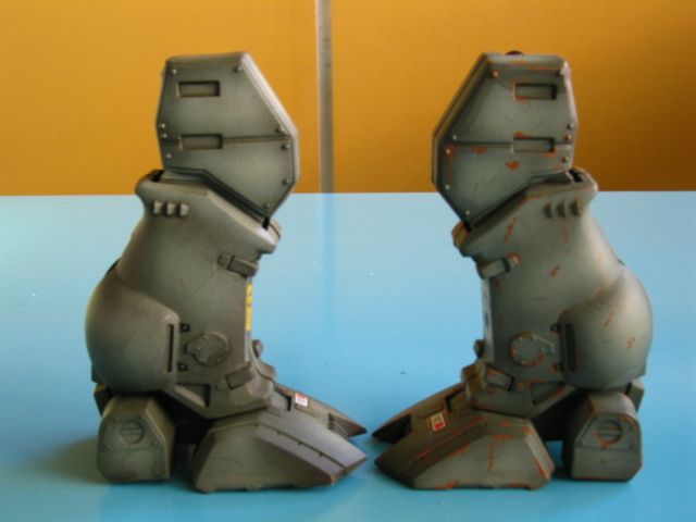

Here's Part 2 of the Tutorial  :)

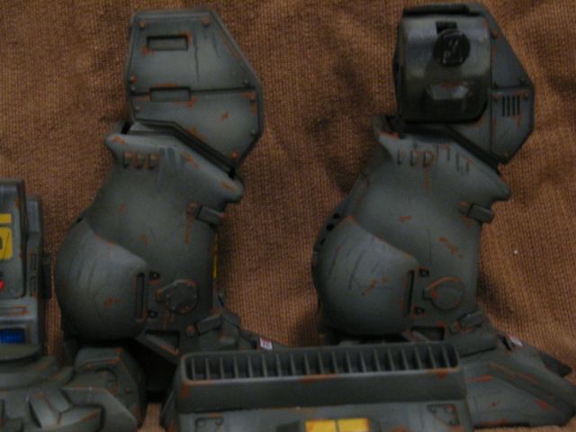

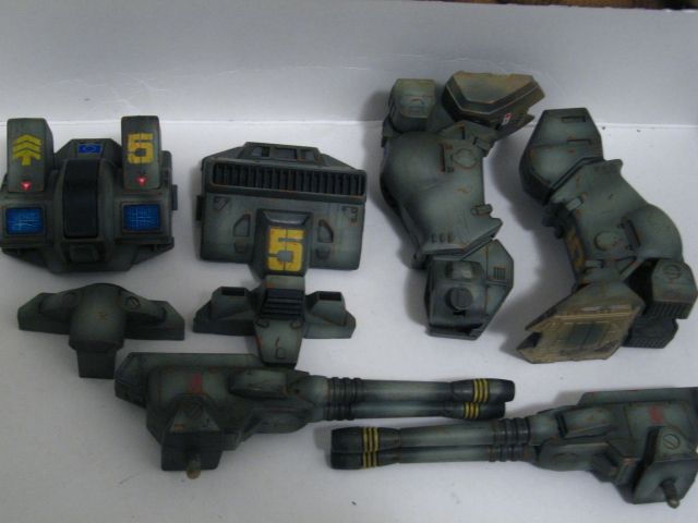

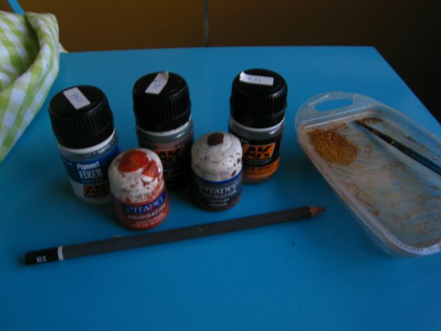

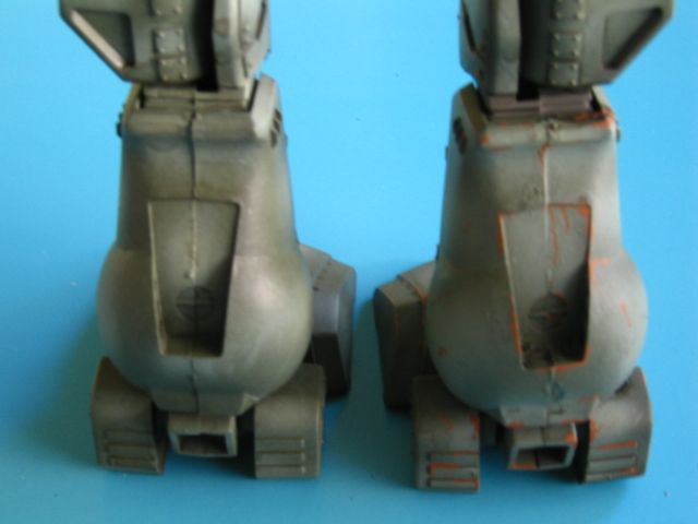

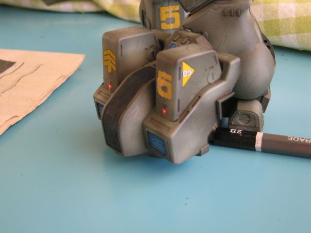

Materials used for the Weathering
i used a soft Pencil to "drybrush the sharp Edges of the Model,also added some Scratches here and there.
before/after
next came the Rust  lol Mixed GW Calthan Brown with GW Macharius Orange,watered down with Vallejo Matt Medium
before/after

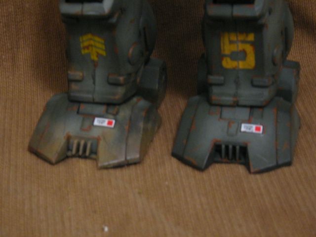

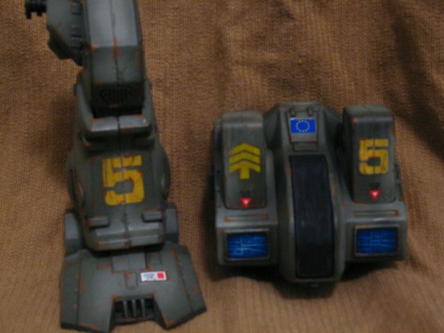

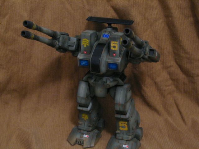

Okay, hope you can see it on the next Pics: Streaking Grime
First i painted small stripes n Dots (the dark Grey Paint ;))
Streaking Grime takes about 20-30 Minutes to dry.After that i blended it with White Spirit.The Result is a light Grey Chalky Effect,just like real dried(Rain) Water,very subtle but also very cool  ;D Sorry Pics really don't do them justice  :?

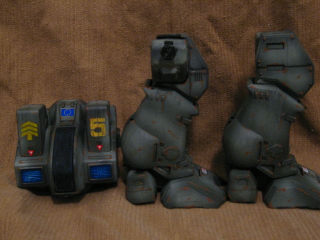

then i came to the Weathering Pigments,not much to say here,i drybrushed the Powder onto the Model and fixed it with Pigment Fixer.Earth Tones for the Feet,Black Soot for the sooty Parts...
after/before

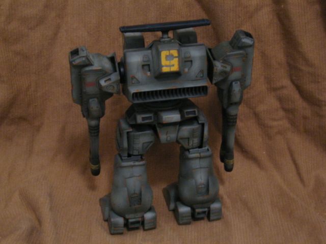

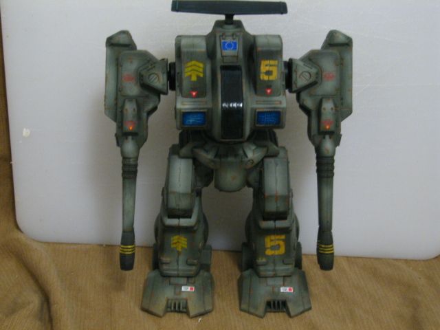

Finally, Vallejo Gloss Varnish for the Cockpit Dome and the Headlights-finito  ;D
Yup,thats an inverted 5  ::) ::)
NEXT!  8)

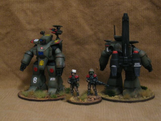

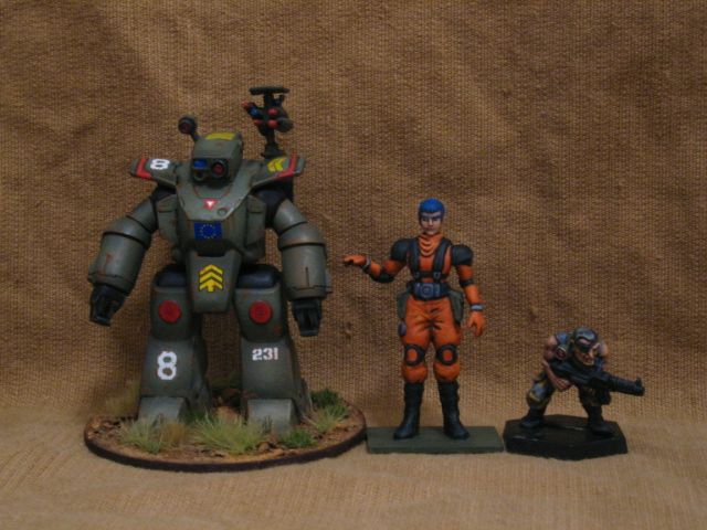

Long Time no Update,sorry Guys  :'( finished few more Pieces at least  :)
Light Mechs for the FSE.these are 1/35 powered Suits from Crusher Joe,pretty slick Models me thinks...
Size Comparsion with a certain 1/35 Pilot and 28mm Mini

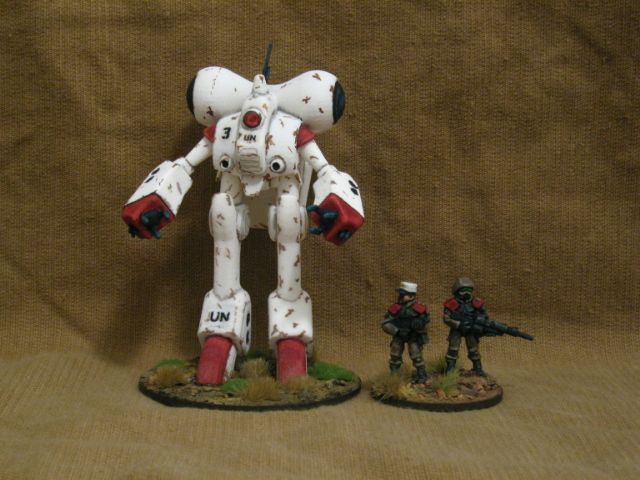

next is a light Mech for the UN,not very keen on the Model a bit pricey for what you get, it's the 1/144 Quaedluun Rau from Shapeways,still looks good as a light Mech next to 25mm Minis  ;)
erm,another Project but fits in here aswell  ;)
thanks for watching  :)
