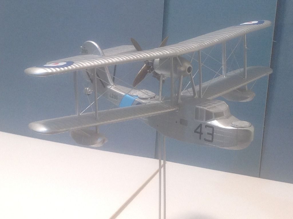

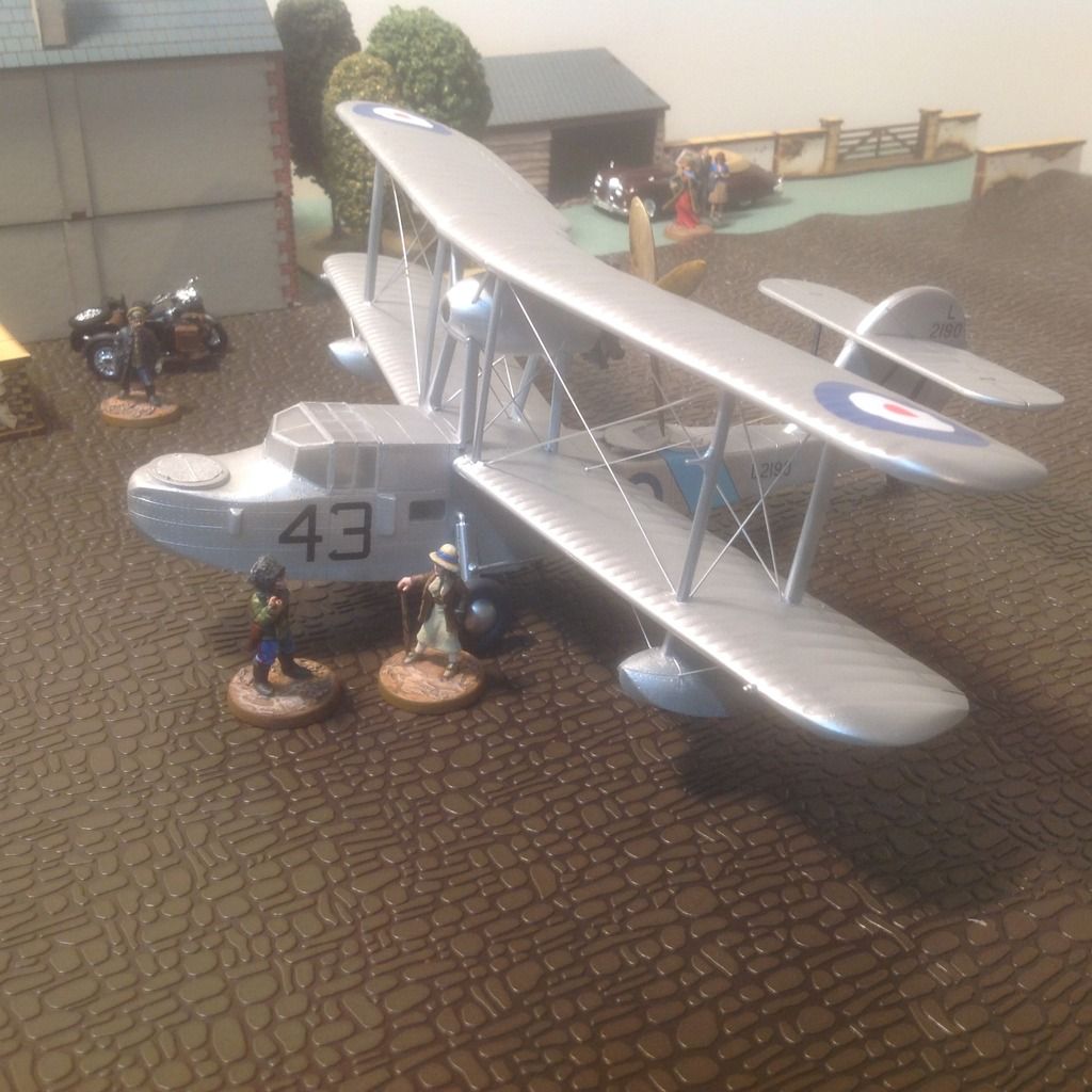

I think this has made the list already, but another showing.
1:48 Supermarine Walrus, from Smer.  I screwed up the cockpit when I oversprayed the model with Krylon clear overcoat.
Picked up some after-market decals from Model Allianace.  The mode represents a Royal Navy aircraft flying on the China Station in the 1930's.

Thanks for all the positive comments!
I modeled this with wheels up or down options.  Used magnets inside the airframe, and then on the landing struts.  I had to modify the struts to sit on the airframe, and they are not parallel, but this isn't too noticeable.
The aircrew inside are painted up, but not as interesting as yours, TSG!.  I have done some initial tests with brush on gloss coat; so far inconclusive.  I am going to try a bit more and see how it works out.
I am still working on decent flight stands, and a "seascape" base that it can sit in for water landings.
The Walrus in flight!
I have several kits to follow this, including a Macchi Castoldi M.C. 72 (also from Smer).  However, I think the next project is going to be the Curtiss P6E Hawk from Lindbergh, which I got for Christmas.

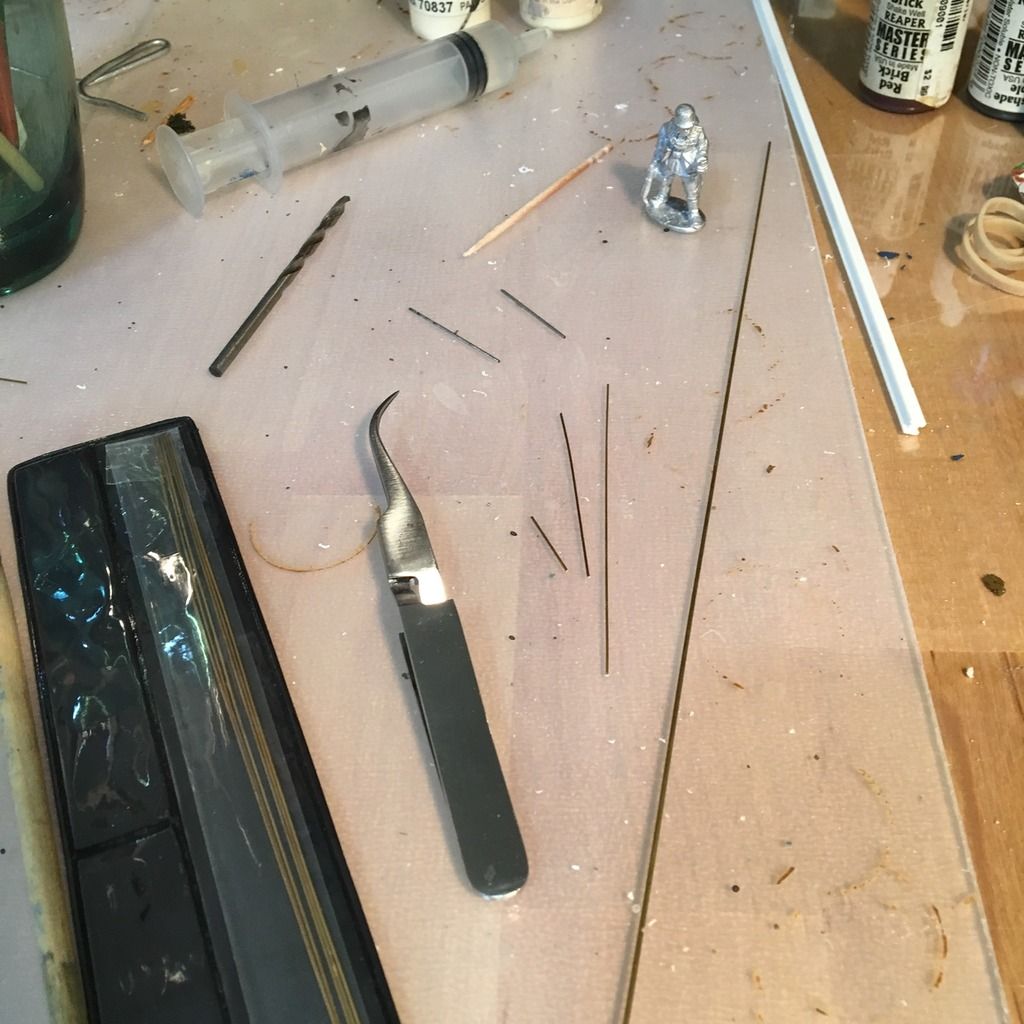

Matt - - what did you use for the tensioning wires?
Ballardian, overlooked your question on tension wires.
I used the thinnest brass rod I could find at the local hobby store.  It looked like wire, but was quite stiff.  I pre-drilled holes with a pin-vice in the locations where the wire would be anchored, and added the rod after assembly.  The engine wires were pretty straight forward, and I added them before the wings went on.
The wing wires were a bit tricky.  I have tweezers that maintain their grip (i.e. You press on them to release what is being held.) that were very useful.  Getting the right length was also tricky, and I had a bit a wastage.  The pre drilled holes allowed me to seat the wires, and then drop on a bit of superglue gel to hold it in place.  A couple of the anchor points are not drilled, and are simply superglued, followed with a dollop of PVA/Elmers glue to hold it in place.
Here is a picture of the equipment, with a 25mm figure for scale.  The rod I used is the short material in the center.  I found a packet of rod, on the left, at a hobby store.  I think it was for making jewelry.
