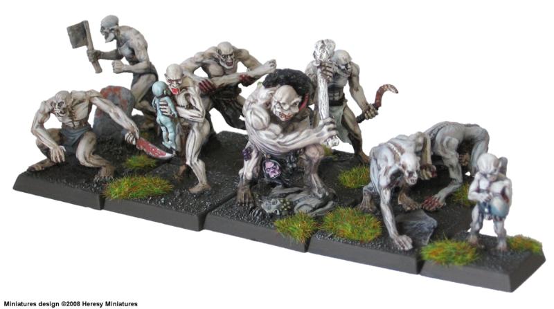

I just ordered the "family" of these delightfully awful monsters from Heresy.
http://heresyminiatures.com/shop/images/large/undead014.jpg
I cannot quite discern what colors are being used as base, layers, and highlights.  I am slightly colorblind and have a hard time figuring these out sometimes.
Can anyone suggest a pallet for them, either Vallejo or GW paints?  Thanks!

Hoi Fellow Erik!
The baby looks to me like they did a very pale color, either a white or slightly off white and then maybe did a light wash of purple all over and then went back and used a stronger version for the shadows.
The adults look more or less the same technique, but with a greenish 'rotting flesh' color.

I guess it depends on your technique - do you prefer to layer opaque (or only slightly translucent) coats of paint to work from dark to light, or would you rather apply a wash to an intermediate tone, then add lighter highlights?
For the former, I would suggest a base coat of Vallejo Model Color Middlestone with just a hint of black or dark grey mixed in to dull it down a bit, followed by highlight layers of VMC Khaki and VMC Khaki mixed either with VMC Buff or White, white resulting in starker contrasts.
After you've finished, I'd suggest putting on a very, very thin wash of the base colour to tie in all the highlights, but it should be a really thin mix.
For the latter, I would start with a base coat of VMC Khaki, then wash with a very thin "warm grey" or maybe VMC "Russian Uniform" (which is a brownish green). From that, use Khaki mixed with Buff or White as above.
The "Baby Zombie" would work well with a light gray basecoat (e.g. VMC Deck Tan) followed by a mix of purple (strong component) and dark grey (just a hint again, to dull it down) applied as a wash, then highlight using the wash mixed with some lighter colour. Alternatively, use very thin washes only, strategically applied as Too Bo Coo suggests.

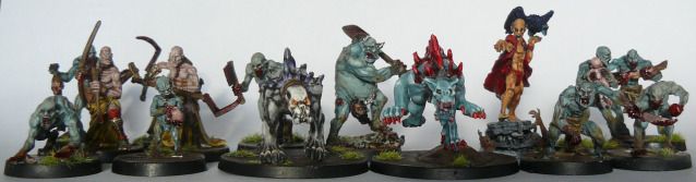

I love these minis.
Here's how I painted mine.
Got the whole set too. Nice muller sculpts.
I think it was a blue grey colour and lots of muddy washes and blood

Beefcake - your Tunnel Dwellers are EXACTLY the color I'm looking for (also ordered a set of those guys with the huge maggots... ew!)
I like your green but I'm looking for a more pallid, very slightly green.
Awesome job on that big group there!

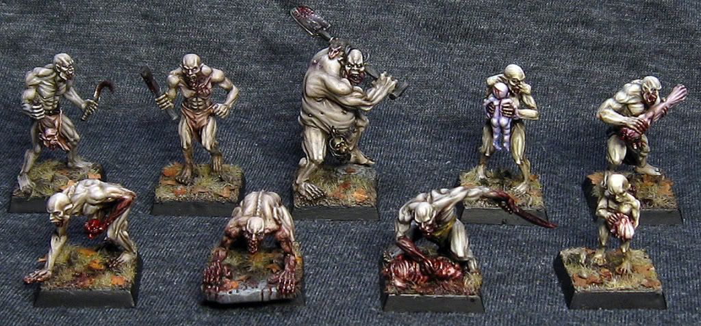

Alright, I used the German Camo Beige (like khaki) under several layers of grays.  I did not get as much contrast I *thought* I wanted so I washed in some purple and burnt sienna washes thinned with glaze medium and water.
Now, there's a little too much contrast but I still like what came out.
Chris, you were right about the beige/khaki basecoat under cold grays.  I never would have thought of that or seen it myself.  Great advice.  Danke!
Now, trying to get the bases figured out before I apply blood.  I'll have to be careful with that - less is more.

That's great to hear! I guess the contrast issue is a very fine line to tread, and personally, I'm inclined towards "less is more" as you describe for the blood. Very happy to hear that my suggestion worked for you. One might try using a darker tone as a base since you said it wasn't strong enough for your liking.
