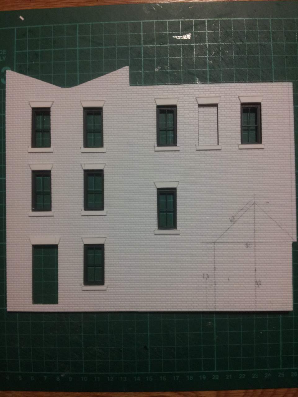

Back. You'll notice I've gone for a mock window top right centre. The scribblings bottom right are for an outhouse:

Here's a breakdown of how I've added the details since the last post.
For the windows I use these from Grandt line. Note they are S scale which I think is a good size for 25/28mm. I use these two patterns more than any other:
Here's the business side. To help secure the windows in place I stick off-cuts across the window frames. For the large window I cut the shape of the frame myself from styrene plastic (three attempts no less!) and embedded it in the wall. The small plastic squares are to help secure it in place:
For the lintels I cut the shapes I need from 1mm styrene plastic sheets:

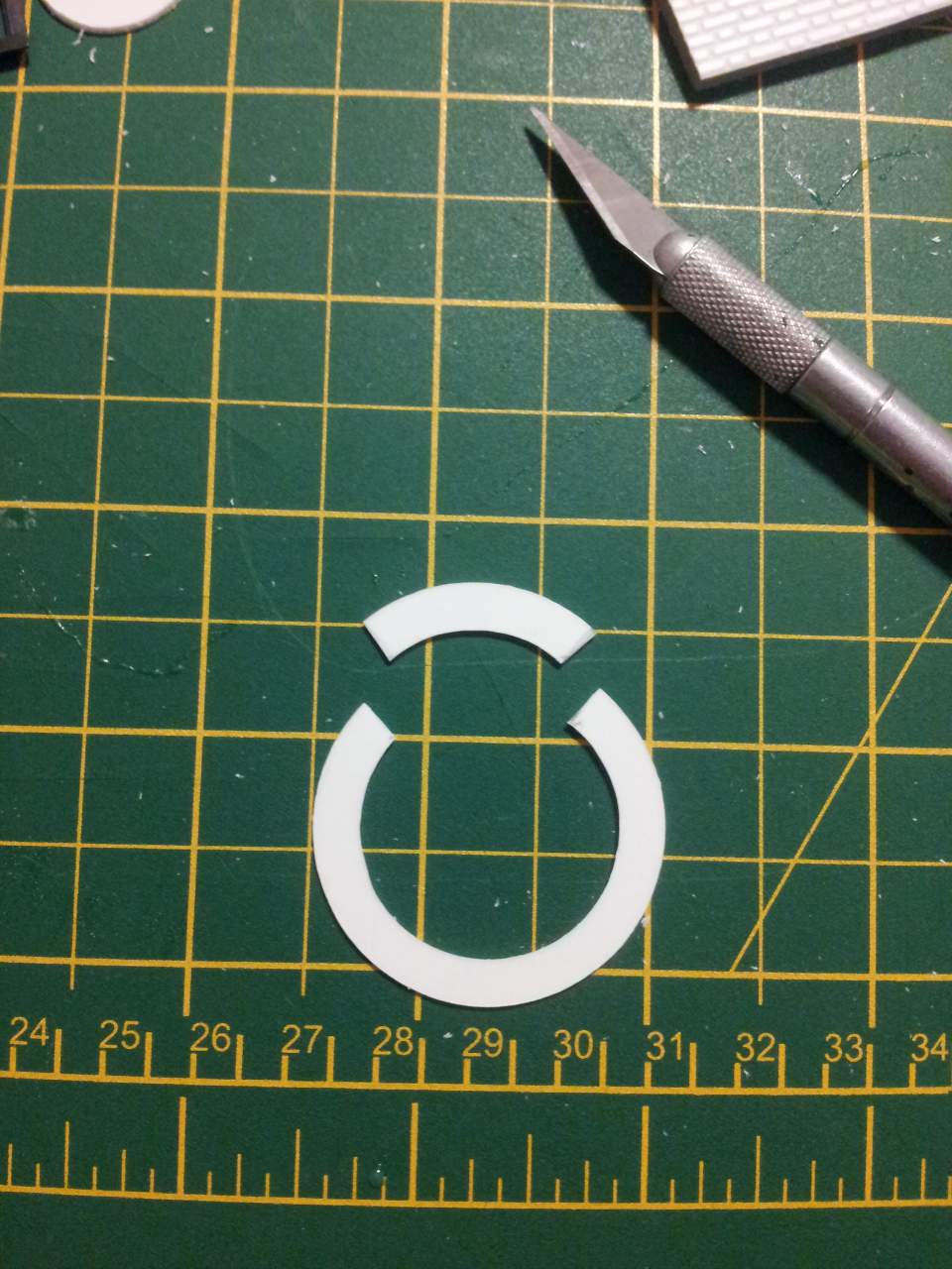

You'll see from the side section there's a curved lintel above the door. For these I cut a 'ring' with the required width and diameter using a cutting compass. I then cut the lintel from that:
