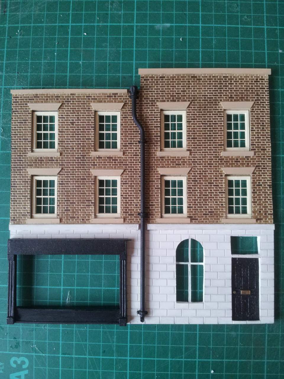

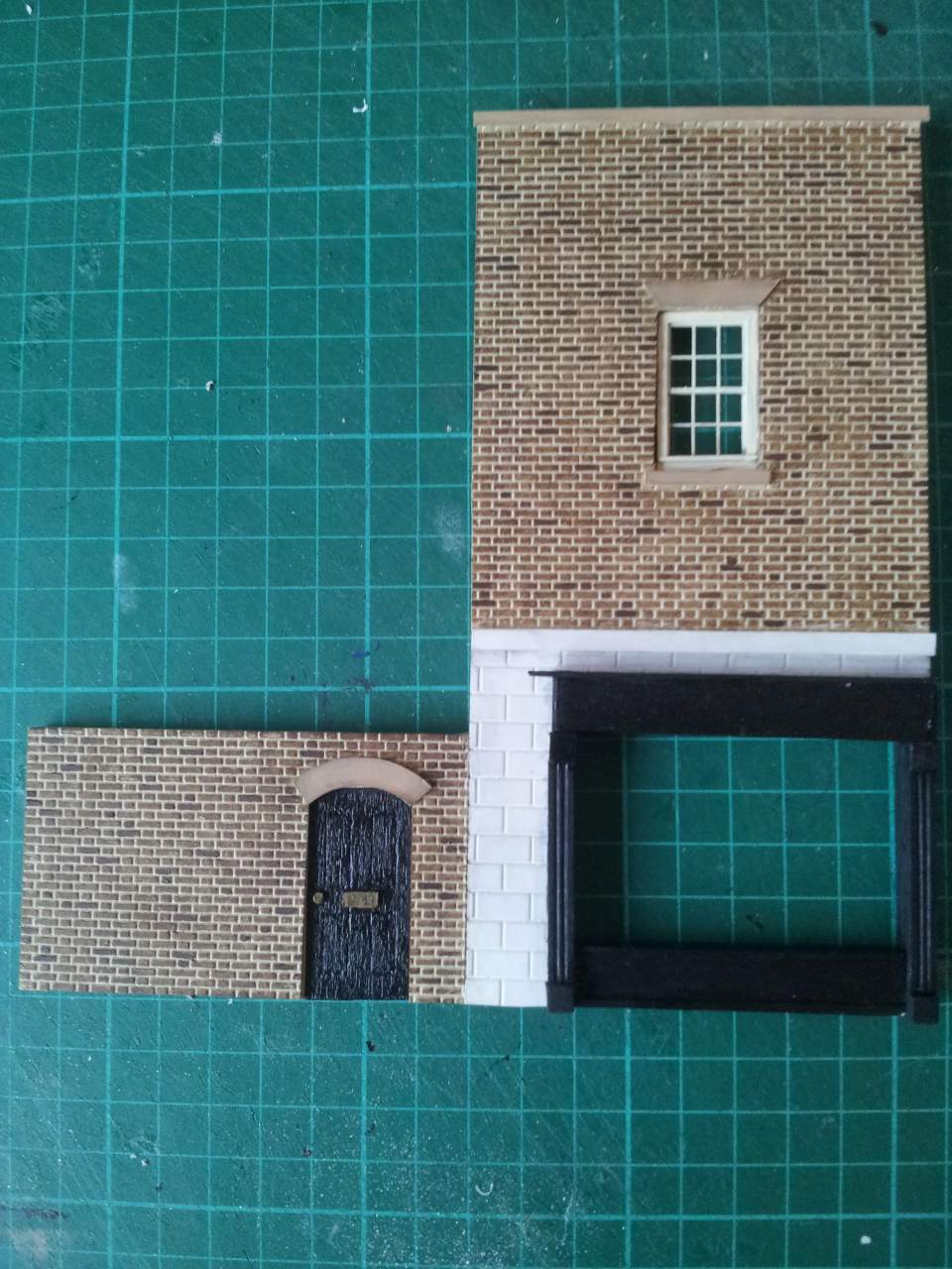

I painted the bottom half a mixture of off-white and cream, I then gave it a very diluted black wash to bring out the stonework. I painted the lintels Vallejo Iraqi Sand and I'll weather them a wash of GW Devlan Mud (may be called something else now) later:

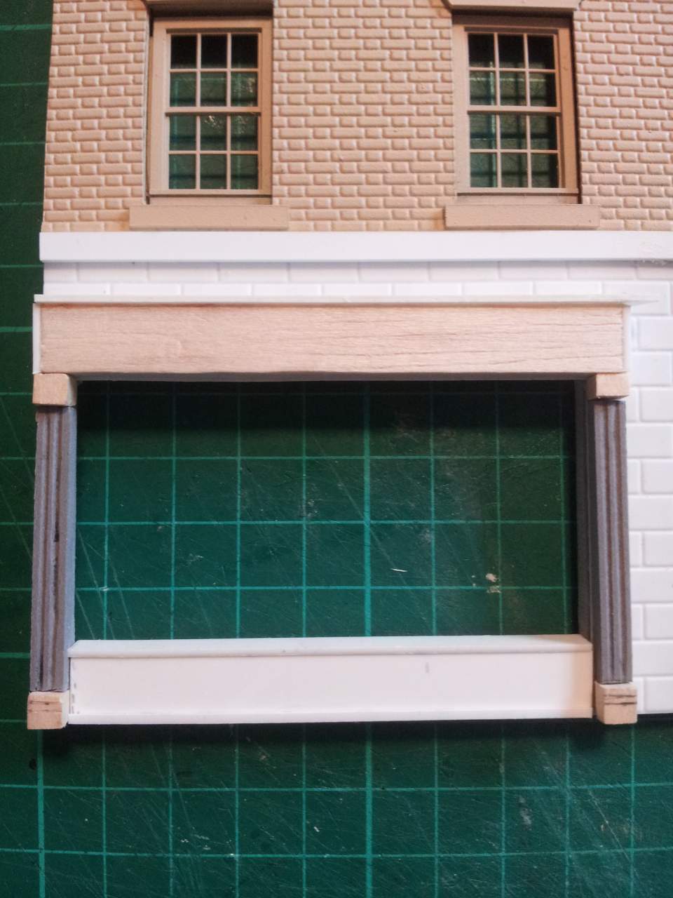

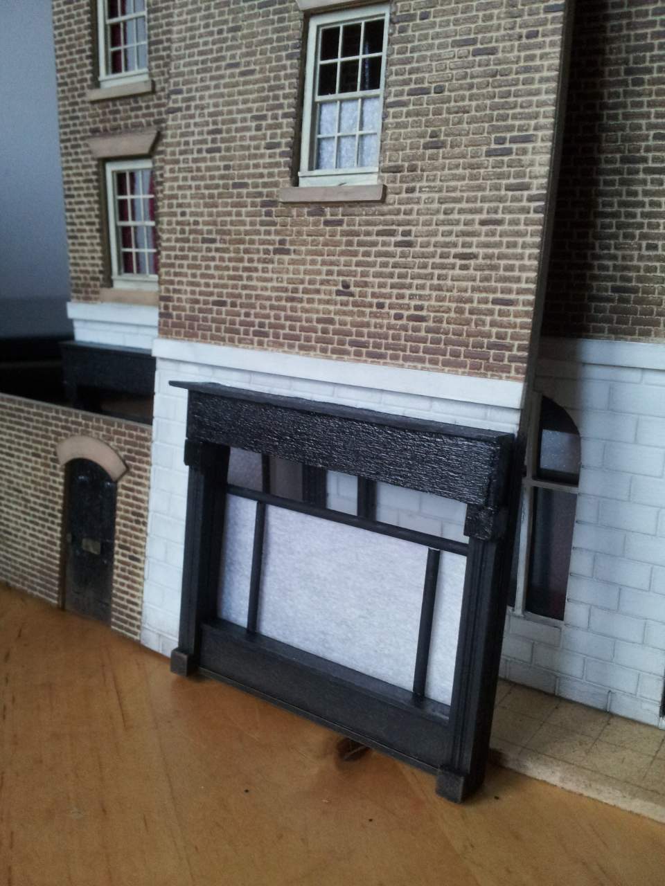

Here's how I made the frame for the shop front. As you can see its a good mix of materials, basically I just lay the stuff out on the desk and go from there. I've used balsa wood framed with styrene for the sign. For the columns I used foamed pvc as it is easy to score; as you can see I've made the column supports from balsa. The bottom frame is all styrene. When the build is nearer completion I'll add the perspex window, any sooner and it'll probably get scratched:
Once it's painted it looks much better:

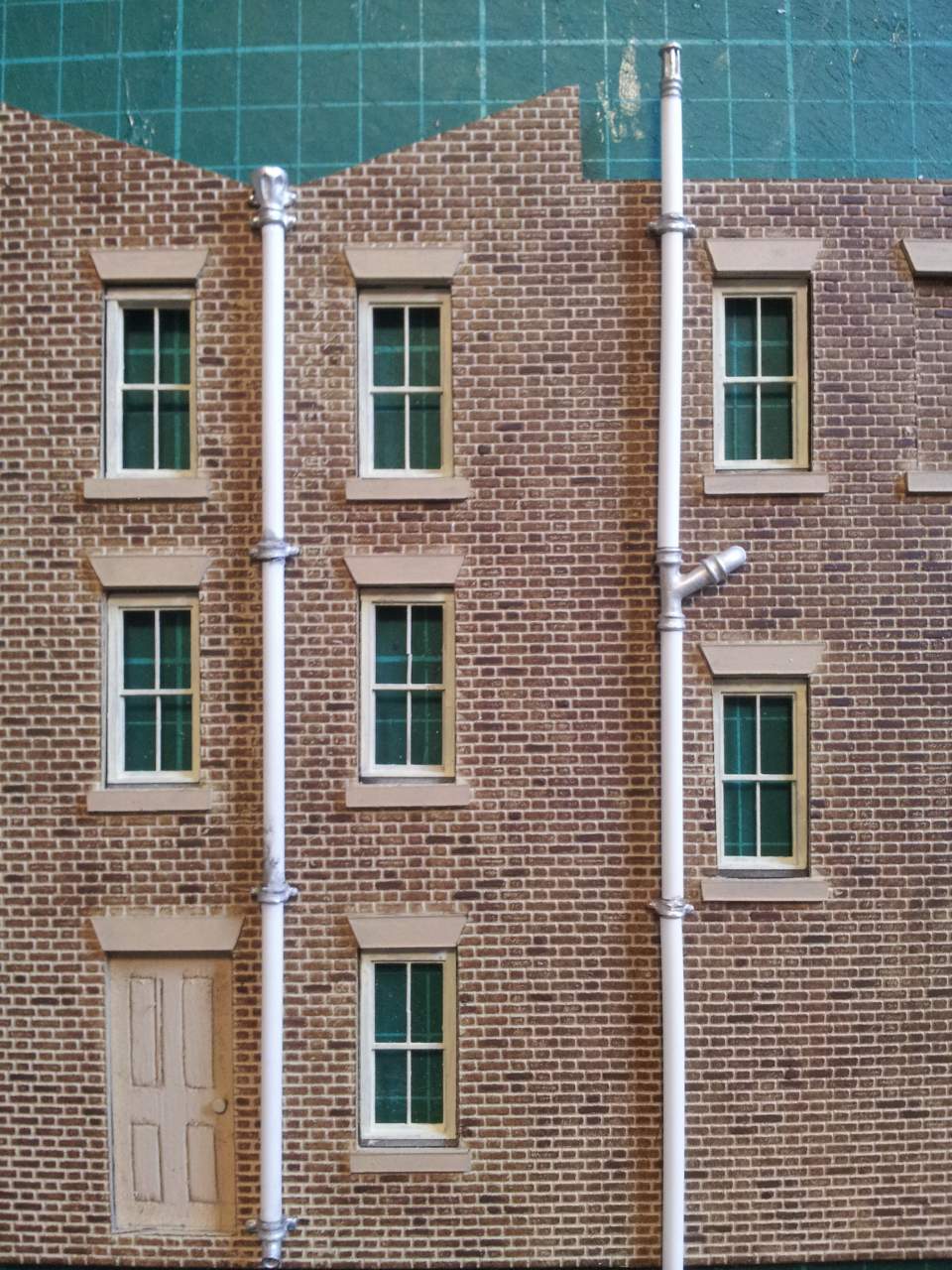

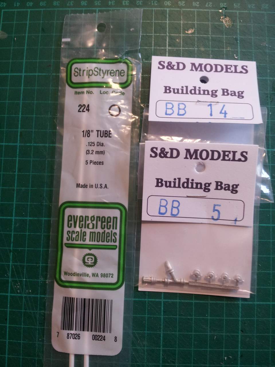

I've also added some drainage pipes (I don't do guttering.......... yet  ;)). I use 1:43 casts from S&D Models for junctions, fittings, hoppers etc. With a slight trim they fix nicely to 1/8th Evergreen plastic rods. When you order the S&D fittings you can choose between 1/8 and 1/32 fixtures, I prefer 1/8 as it scales nicely with the buildings. Anyway, it's these:
As you can see from the pic of the front section at the top of this post I have given the drain pipe a swan neck. The plastic rods are easy to bend with some tweezers but I use a pipe bender to avoid creases or kinks. I got mine from e-bay:
Once I've measured the length of the pipe I will need I just fix it to the fittings and pin the whole thing to the build. Any gaps between the pipes and the fittings are treated with a dose of filler. Here's some WIP drainage added to the back of the building (it's not fixed yet so isn't straight):
Hope some of these tips help  :)

Do you paint the drain pipes before fitting them?
Should have mentioned that, yes I do. I only paint the side facing the brickwork though, I paint the rest once it is fixed in place.

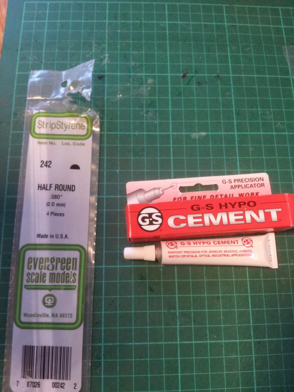

For the frame I use thin half round strips glued into place with GS Hypo Cement, it has a tiny precision applicator which is perfect for delivering small amounts of glue for detailed work:

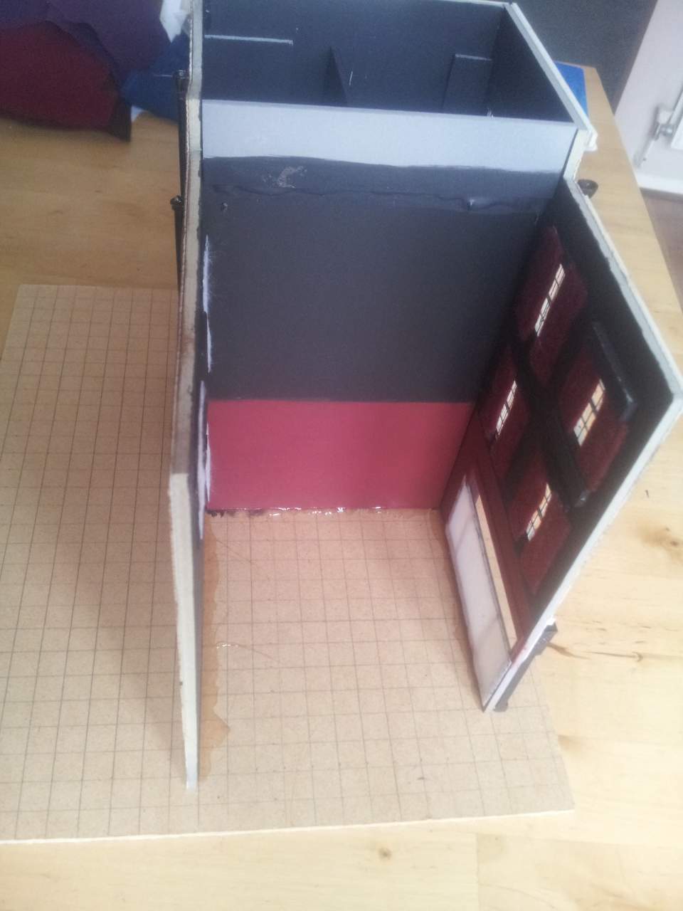

This pic is just to demonstrate how I grid the base, it helps me ensure I've got true right angles, straight lines and everything where it should be. I use Araldite to glue the building sections to the base and as you can see from the top section of the building I secure the corners with strips of foamed PVC (these will also act as supports for the flat roof when it is put into place later):
