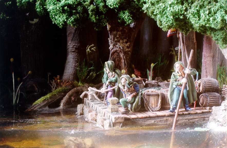

Woodland Scenics. It  is slightly yellow so it doesn't suit all purposes. Also you need to heat it  so beware of pouring it onto heat sensitive materials.
I, when I was a sweet young thing, used it like so...

That's laverly Hammers. How do you get the straight edges? Do you have to build some sort of box for it to sit in before you pour?
