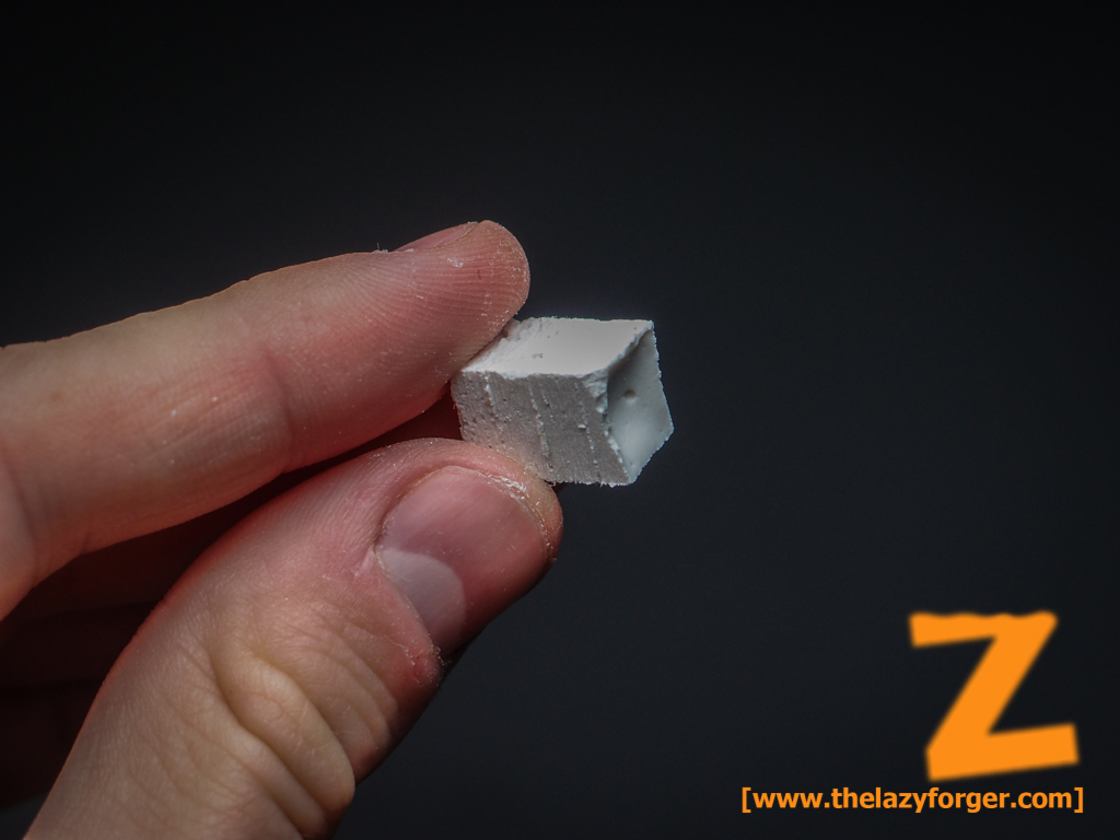

that's the quick preview of my tests: basically, the future was GREAT to prevent the pouring and to preserve the mould, but the non-wet surface (and kind of hydrophobic) generated a lot of bubbles. I don't know how to resolve this issue, for now. :(
That's with the wet mould:
That's with the future:
I tried to keep the conditions as constant as i could, and i even used a control for the test, with a non-wet and not future-treated mold:
any suggestion to resolve this problem is welcome!

Nice work. Could you use plastic for the outside frame of the mould? Maybe combine that with replacing the balsa with a thin veneer of a harder wood, or just use a harder wood for the entire mould. This should make it durable enough to be cleaned and reused.
Offline zizi666
  • Posts: 3558
    • My Photobucket page
Re: Sculpting Bunkers - TUTORIAL
« Reply #24 on: 11 June 2014, 05:55:29 AM »
Maybe try to laminate the balsa with acrylic floor polish (Klear / Future / Johnson's...) or would that soften the details too much ?
*edit*
Doh ! that's what you meant with the future mold. I guess it really is time for me to go to bed... *massive facepalm*
« Last Edit: 11 June 2014, 06:47:37 AM by zizi666 »
Offline Mr. Peabody
  • Posts: 2223
  • Canuck Amok
« Reply #25 on: 11 June 2014, 06:24:18 AM »
Try wetting the Future coated mould and / or try to 'settle' it more aggressively.
Air bubbles aren't uncommon with plaster moulds, especially where there is lots of fine detail. Dental labs use vibration tables to deal with this sort of thing.
Offline maxxon
  • Posts: 672
    • Small Cuts
« Reply #26 on: 11 June 2014, 06:34:31 AM »
You know, the other one isn't bad either. It's different but not bad. It kinda looks like heavily weathered concrete you might find on docks etc. where water gets into contact with the concrete.
Hmmm... Maybe you could try coating the outside of the mold, so it will still suck up some water but not too much since it won't leak through?
Online Slayer
  • Posts: 753
« Reply #27 on: 11 June 2014, 06:39:21 AM »
as others have said I think the second one looks fine, bit more weathered is all
the early bird may get the worm but the second mouse gets the cheese
Offline DELTADOG
  • Posts: 691
  • The two-handed G.E.C.K
« Reply #28 on: 11 June 2014, 01:09:12 PM »
I´ve done that same work for my Fallout Vault project a few weeks ago. IMO Future isn`t that good idea for your Problem. I´ve used spayable Moldrelease from Smooth-on and that worked the best! To avoid the microbubbling in the plaster you have 2 possebilities.
1. Use a Vakkum-System to de-gas the ready mixed plaster before casting.
2. Use LEFAX! LEFAX is a common medicine against exhalation in Germany and Europe in general. I don`t know if you know it or its available were you living. Maybe a similar product under another name would work too. Those medicals use ezymatic incredience to break surface tension of bubbles. LEFAX works fantastic to de-gas Plastermixtures, but not resin! Just pestile it to fine powder and mix it directly in your water you will use with the plaster. Warm up the water a bit will increases the effect.
Offline Sangennaru
  • Posts: 5780
  • The Lazy One
    • The Lazy Forger
« Reply #29 on: 11 June 2014, 01:31:06 PM »
Cheers Gents! I'll try to group-reply by points:
- Plastic for the outside: That's an option, but it requires to switch glue to a super-glue or cyanacrilic which is much less practical than PVA. I would rather avoid that.
- Wetting the future coated mold, or vibrations to de-gas it: That's an option. In my opinion it's still time consuming, but it definitely worth a try.
- Coating the outside of the mold: that's a neat idea, i'm not sure it will work but it surely doesn't damages!
- The LEFAX solution: seems interesting, i'll study a bit this option! Maybe now with a medicinal, but there must be several other products with a similar property, no?
- Keeping the mold with the bubbles? Nope: it does look as a damaged concrete, but the damaged concrete does not have bubbles, but holes. If i want to make a damaged concrete, i will rather carve holes in a bubble-free piece! :)
cheers again and thanks for all the suggestions, really appreciated! :D :D :D
