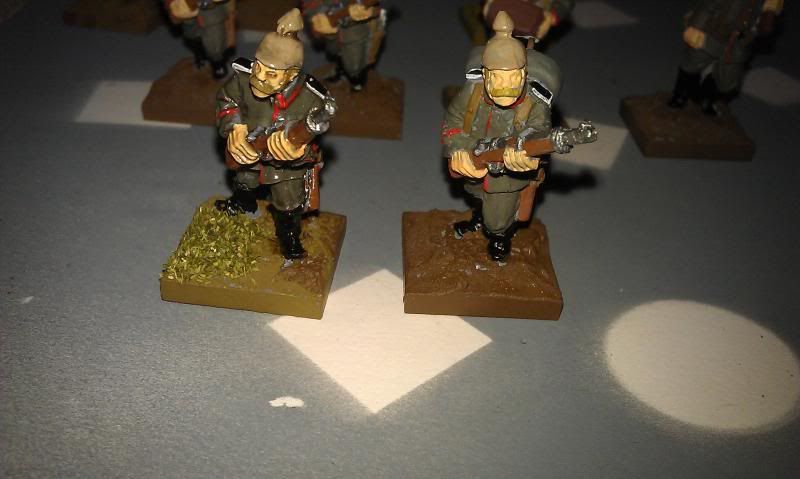

here is a side by side comparison. The left figure has had Army Painter quick shade brushed on and the right one has not.
