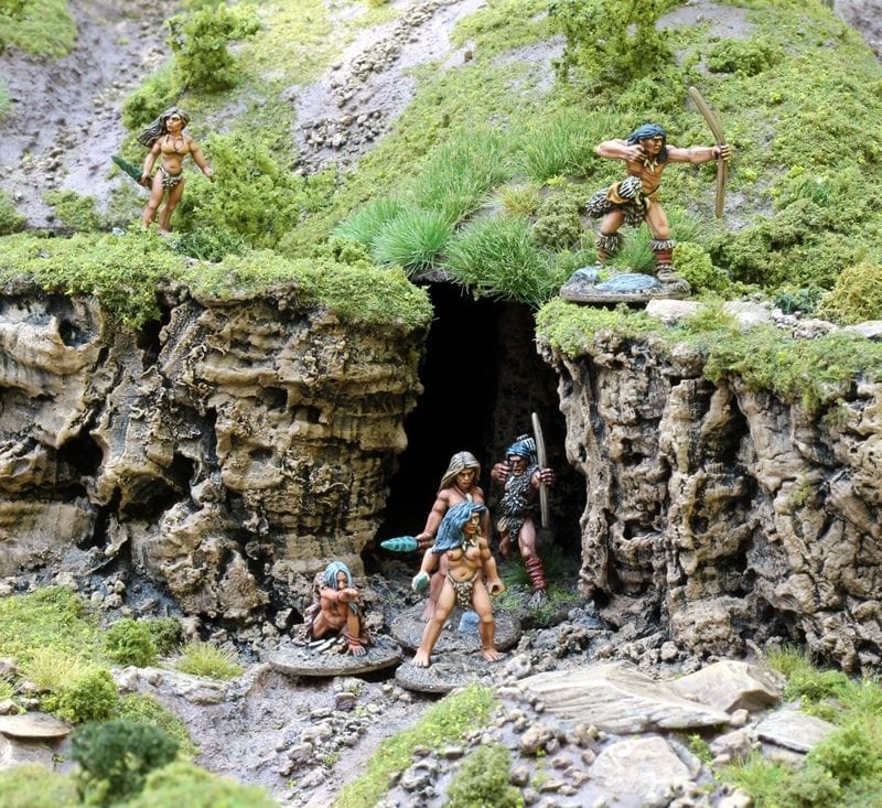

« Reply #8 on: December 05, 2015, 09:19:32 PM »
A big thanks for all the advice received.
I've now finished the first 6 of 30cm sq tiles which are in the main project thread ....
http://leadadventureforum.com/index.php?topic=83691.135
......but here's a taster I've what you helped me make:
Thanks for taking the time to guide a coarse turf virgin! :)
