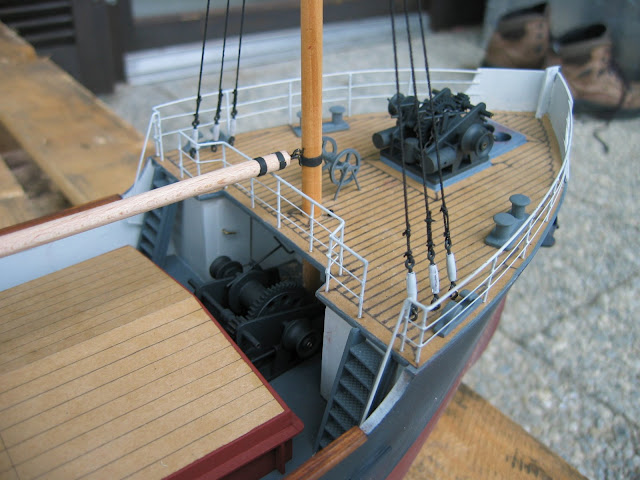

If you want a steel railing, I recommend brass wire. The top rail sits on top of the stanchions, the lower one (or two) behind them. Of course this does not look exactly like the real thing, but from the usual viewing distance you don't see much difference. Another advantage is that you are free to chose the height you want. So this is how I do it:
1.  Drill holes into the deck, protect deck with masking tape
2.  cut stanchions to length, file the top end flat and set them into the holes
3.  Lay the top rail onto stanchions (stick some clothes pegs on so it doesn't fall off sideways)
4.  Solder one stanchion after the other
5.  Lay the lower rail on wooden blocks of the correct height and fix it again with clothes pegs or whatever Comes in Handy
6.  Solder lower rail to stanchions
7.  Take to whole thing off, clean off flux residue, paint and glue to the deck
8.  Bob's your uncle!
It takes good practice at soldering, you need to be quick, otherwise previous solder joints will spring open again, and subsequent coarse language may occur. I found it helpful to have a bowl of water and some q-tips at the ready.
The result is quite strong and will punish anyone who steps on your model (apparently this happens sometimes, according to the less-than-brilliant-model-making thread).
This is how it Looks on my freighter:
The lower rails in this case are made from guitar-string, which I do NOT recommend, you can't solder it.
And don't be surprised if you feel a bit befuddled after making it all in one go.
Peter

You never really went into much detail about your pulp boat there. I remember you put up a picture of it underway, as it's a working water-borne model, but not much detail. Was it scratch built from plans, or part of a kit? And where did you get those crane/hoist/winch fittings? Did they come with a kit or purchased separate from a model boat supplier? They look great.
Offline PortCharmers
  • Posts: 46
Re: Boat 'stanchions' needed
« Reply #14 on: 20 March 2016, 09:27:19 PM »
Hello there,
it's scratch-built following a plan of the Gowerian, an english coastal Steamer built in 1921. The raw build is according to plan, but I used ready-made details offered by several manufacturers wherever possible. For the winches i bashed a Graupner kit for an electric anchor winch. The basic frame is made from a cd-case, the shafts are brass tubes, the cylinders dowels. The conical drums at the sides, band-brakes and chain-nuts are taken from the kit, the gears from a small Tamiya gearcase-kit.
I had to make them myself because the wonderful winches by Calder Craft would have been to big. Besides, building myself resulted in the same level of stylization on the whole model.
