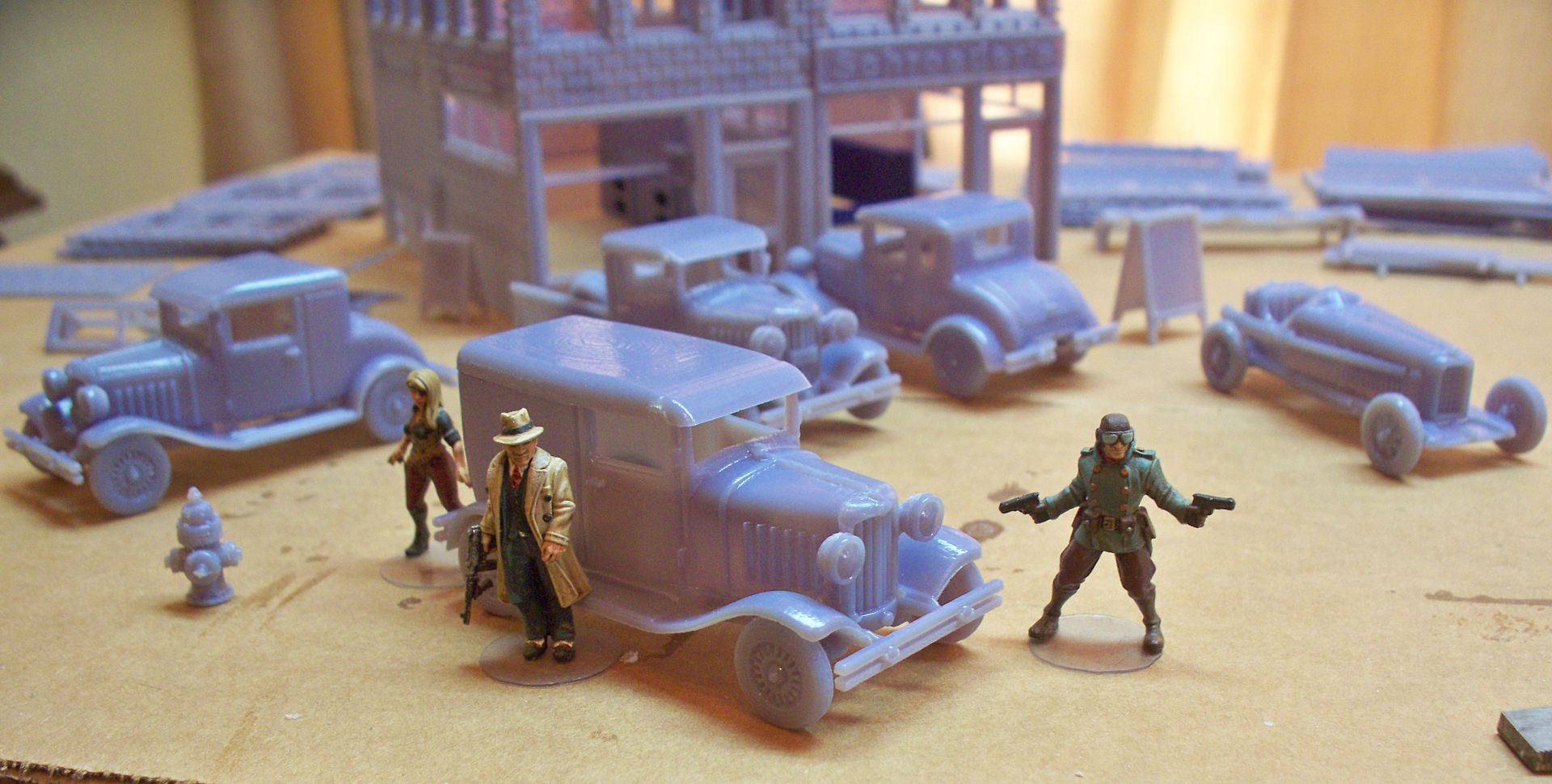

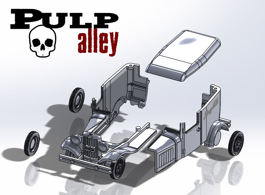

I've been working on some new vehilces for our Pulp Alley game. And here's a view of one of the vehicles I finished today. I printed it in several part to get the best quality...
And here's how it looks -- along with a bunch of other pieces I printed...
HAVE FUN

That looks terrific :)
Offline marianas_gamer
  • Posts: 4137
Re: Pulp Alley 3d Prints
« Reply #2 on: September 28, 2016, 10:23:55 AM »
I like the  Model As  :-* :-*
Lon
Offline Michi
  • Posts: 4453
  • Hoist the colours!
    • Tableterror
« Reply #3 on: September 28, 2016, 10:41:05 AM »
Alright, now add windows to the panel van to have a sedan, skip the roof of the coupĂ© to have a roadster, swap the flatbed of the pickup for one above the wheels to have a stake truck, box van and similar and the collection of model variants should be complete. You could easily get a monopoly as pulp vehicle supplier once they get into production...  :D

I'd be tempted to try them with bigger wheels though. They look a little under-wheeled at the moment. Ignore scale, go exaggerated! :o

Love em
Will these be resin cast eventually?

It wasn't so off-putting that I felt it was worth posting about earlier, but I've been kind of thinking the same thing?
There's a limit to how much Dave can change things without the fenders looking wrong or even touching/conflicting though. And tweaking the overall model is obviously much more work.
I wonder what others think?

You could increase the wheels diameter by 2-2.5mm. Simply by dropping the axle stubs down by 1.5mm. without effect in the geometry of the rear wheel arches.Personally I feel the coupe is proportioned quiet nicely and that the wheels will work with a lick of paint.
Dave you should be able to achive a larger feeling wheel by increasing the diameter of the wheel hub and reducing the inner diameter of the tyre.
I'll have a better idea of how you think once I've rummaged through the box of your prints Chris sent me later today ?
I think a floor pan with a front bench seat would add the depth needed (stopping that slightly hollow feeling they have) but more importantly adding structural support and strength around the area the vehicle is most likely to be picked up at.
Mark.

these look great, the print quality is very nice - if I may ask what type of print do you use?

Now that you mention it, the smaller hubs and thicker tires may be what's causing the effect where the tires appear "small".

There's also that we're viewing the cars from an uncommon angle. Mostly we see cars from a much lower angle - and to look super cool cars are often photographed and drawn from axle height. Since these models will mostly be seen on the gaming table from a high angle, that's why I'd suggest some exaggeration.

I thinl they are lovely! They reserve to be issued in a Commercial scale but please add and suitable drivers and some passengers, too.

But a lot of us really want "gaming miniatures" or models if you like, priming and re painting "toys" is bearable but I'd always prefer something designed to fit in with the other minis.
Yes to drivers etc!

Andrews right when sculpting you do need to know how to exaggerate details for perspective 'fit' But more importantly know how to do so taking peoples preconceived notions and stereotype's,Then throw it all in a pot and sprinkle in a little dose of casting tolerance's and a splash of voodoo.
Or simply call someone like Andrew or me,and take all the hassle out of life.
To the point I've just had three Opel blitz truck prints land on my desk to day to convert to cast.
Dave the best thing to do with them now is to stop. Take a step back sidetrack yourself with another project(just to clear your mind of the design )Then after a couple of says come back to them and Paint what you've printed. You'll learn more about what you've sculpted this way than looking at the screen.
The figures you placed in the pictures give some sense if your scaling process.
Which is where Andrews observations come in.Your preference for thin bases keeps the perspective of the wheel sizes in the print.But the second you use a more traditional /common style of base .Your eye gets drawn and you start see the wheels as being undersized and toy like.
So you play with perspectives and oversize some detailing.This does take a lot of practice and experience which is where people like Andrew and myself kick in.
That said there's a simply solution for everything,if you base the vehicle (it must be thinner than the figure base)then you dampen the effect as it fools the old nogging into re setting its idea of perspective related logic and everything becomes visually comfortable ,try it with the same thickness of base or thicker and it has dramatically the opposite effect. (This is why some people don't like bases on vehicles .)
Mark.
