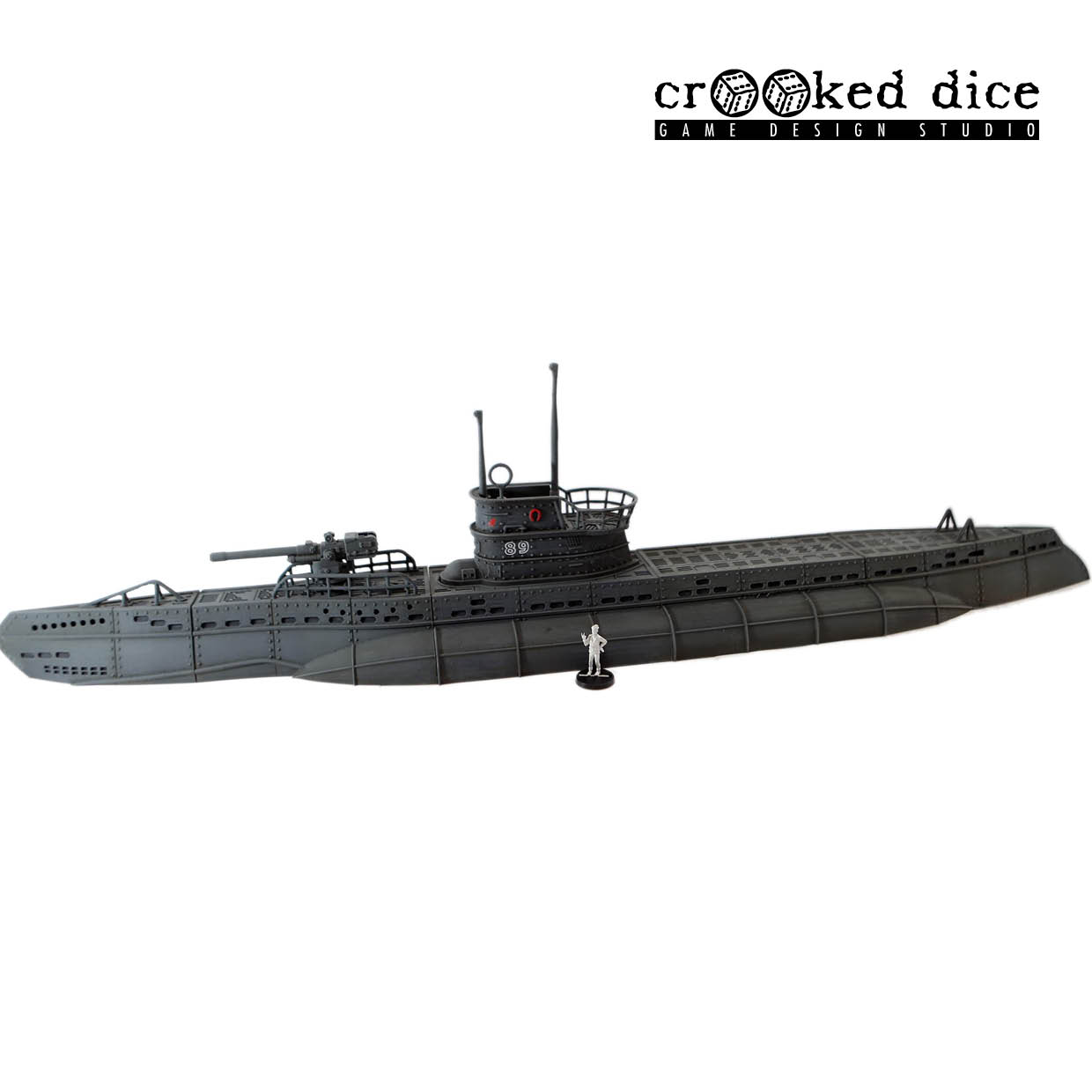

Crooked Dice U-boat
While Crooked Dice offers a good selection of pulpy miniatures, just like most miniature stl files out there they are scaled for 28mm and would require a bit of "chunkyfing" to work well on 15mm scale. However, their terrain and vehicles would scale well enough. The U-boat is a staple of pulp, and their model would scale down to 15mm without much issue. You'd probably want to print the railings on a resin printer to be safe, but the u-boat itself would print just fine on an fdm printer.
