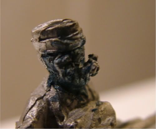

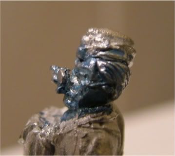

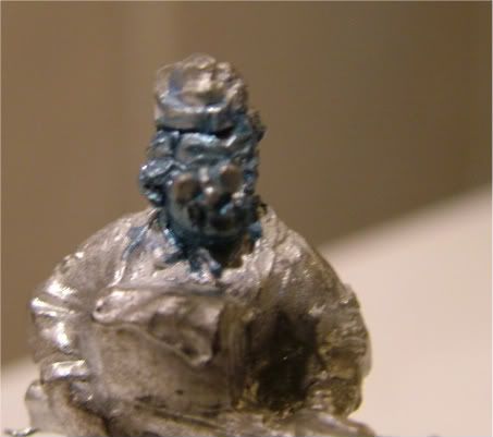

I bought a pack of foundry Home guard heroes for ECW
Private Jones has been in the wars already.
Now if it was a zombie it comes with half his face chewed off
