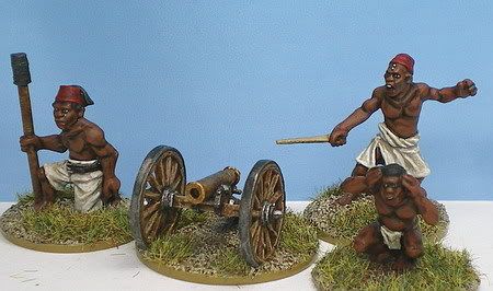

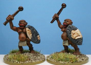

« Reply #12 on: May 17, 2009, 04:43:42 PM »
Finally seems to be working again, so as promised some examples of my negro skin:
All done to the same recipe, more or less. There may be some variation in the final highlight.

Offline Mad Carew Snr
  • Posts: 489
Re: HELP! How does one paint Zulu's skin?
« Reply #13 on: May 17, 2009, 04:59:09 PM »
Hey nice work Bob
The guys with the shields look like something out of Tintin in the Congo! Where do the figures come from?
Online JollyBob
  • Posts: 4620
  • I've only had a few ales...
« Reply #14 on: May 17, 2009, 05:31:59 PM »
Cheers.  :)
Those little guys are Kallistra pygmies (listed under 28mm Fantasy).
http://www.kallistra.co.uk/
I have far too many of them to be sensible.
