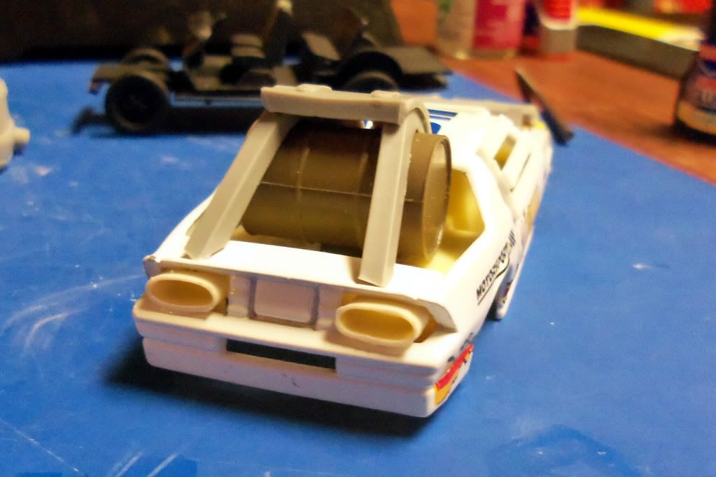

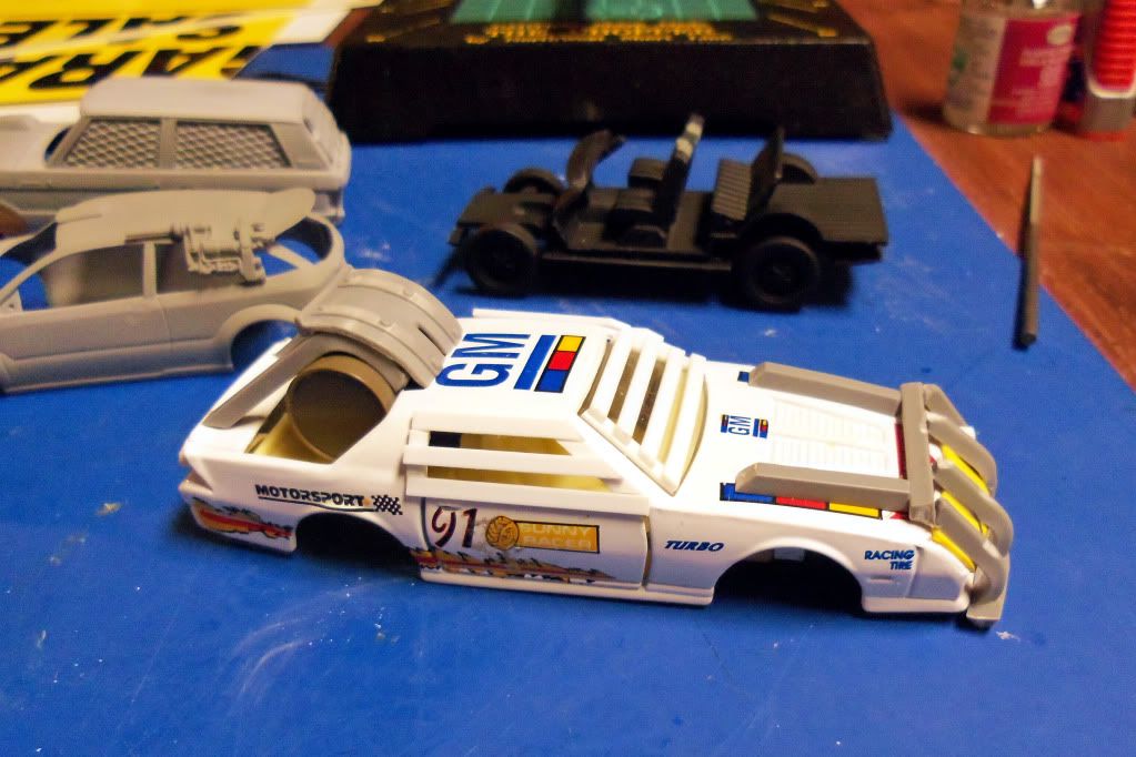

Ive been wanting to do Car Wars in 1/43 for years and years, just never go around to it. Well, I finally got started. My cars and terrain are kinda going more generic dark future than true Car Wars, but thats because there are many different poccy-clipse games out there I would like to use this stuff for.
This was an ebay purchase, advertised as 1/43 but closer to 1/35, full of blobs of glue. Being cheap and stubborn, I was bound and determined to make this work. First I stripped out the insides and cut a 1/2" V from the front to the back to make the car narrower. Then I rebuilt a (crappy) scratch chassis with the frame lowered to lower the overall height of the model. lots of filing and sanding has me to this point.

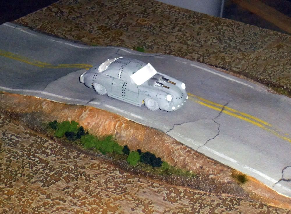

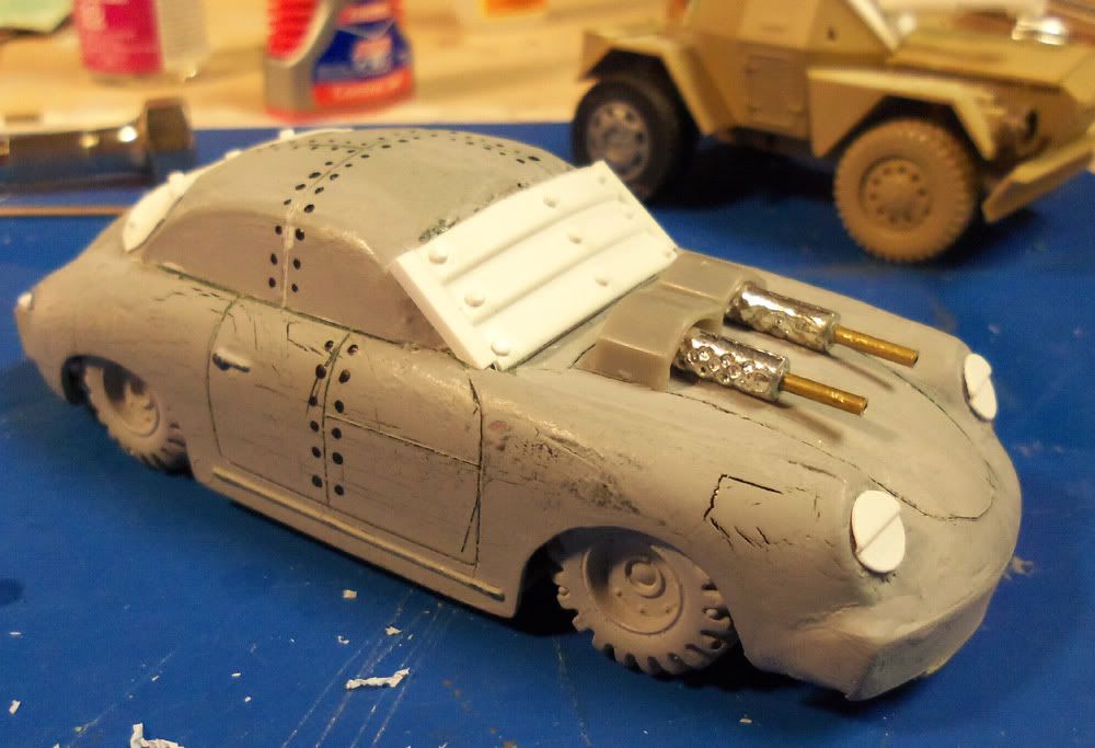

This one is a Dingo scout car, reversed.

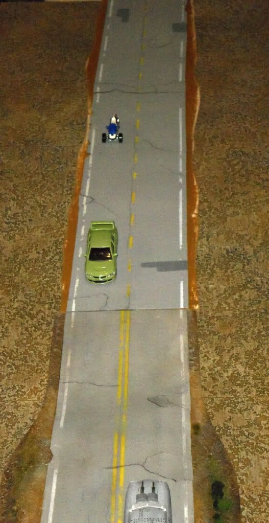

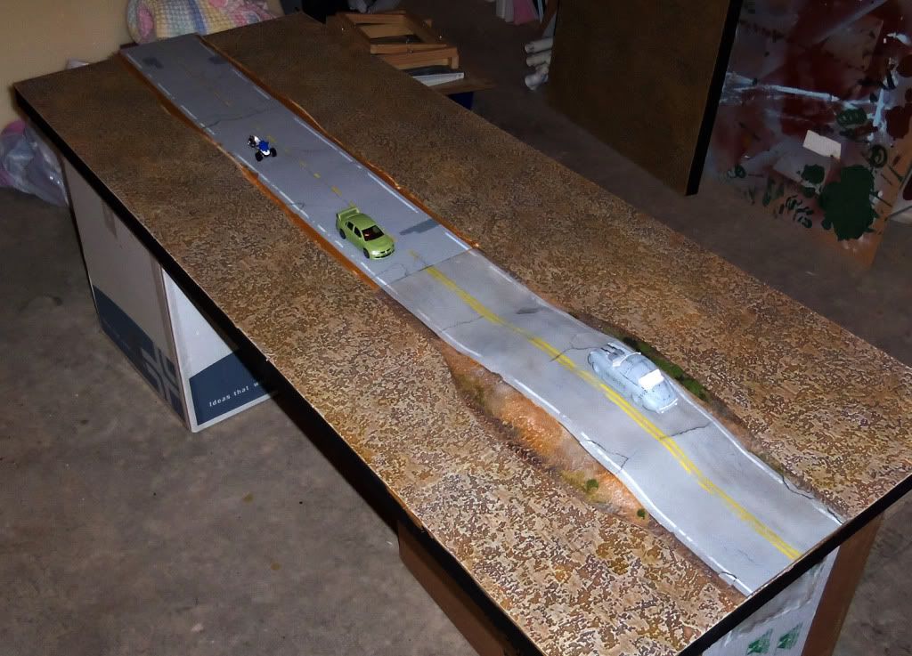

The first finished road section.
Finished and WIP roads on a section of game table.
another shot, for scale.
Questions and comments, lets have em!

Nice looking work there Pappa! I am feeling the first car,quite nice. How did you do the surface of your game board?I hopped on the PA band wagon about 8 months ago and I am getting around to the board and I really like the look of yours.I live down state from you in galesburg,have to get a game on some time. I've been busy but I'll get some terrain shots for ya,havn't forgotten 8) Drop by over at post apoc wargames in the meantime. I Have a good bit over therehttp://s1.zetaboards.com/Post_Apoc_Wargames/index/ Mr. Clean is from chicagoish as well and he posts over there too.

The board is three sections, a 5x4 and two 2x5s. That way I can have a 4x10, a 5x8 or a 15ft long run into a town area if i wanted, or I can use them individually for smaller fights. Theyre made of 1/8 mdf board on a slat frame, to keep the weight down. The top is paintable wallpaper that I found at Menards. the paint was from Home Depot, in the oops section (improperly mixed paint, sold for 5 dollars a gallon). The base is a "poo brown" as my daughter calls it. (probably why it was 5 dollars) on that I drybrushed a bone color (1 dollar in a quart).  When dry I applied a watered down wash of Dark Burnt Umber ceramcote. (craft paint) More bone color drybrush on that after its dry, foloowed by a wash of the the original poo color , watered down, to tie it all back together.

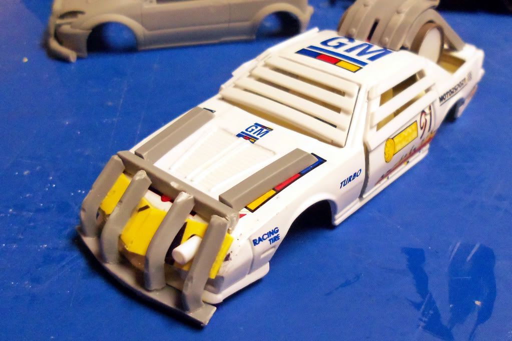

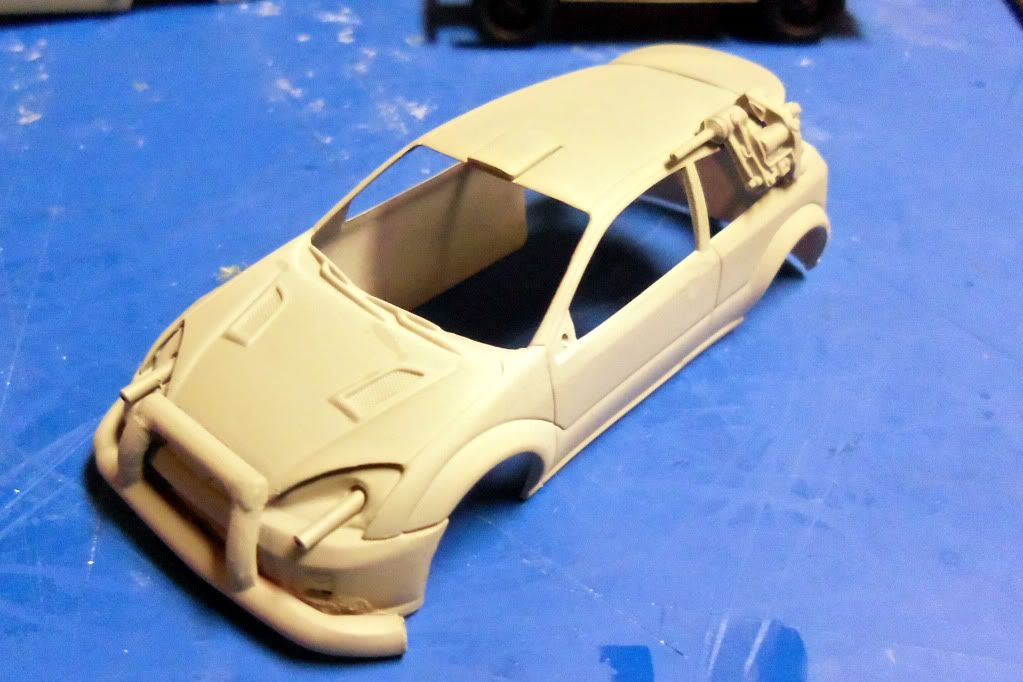

Got a few more on the workbench; chassis only right now:
  Heavy armor and extra fuel bring out the "Rat Rod" styling on this car. As this was the only die cast of the three, I found it really difficult to work with. I started out hateing this car, nothing I did looked right on it. Eventually, it grew on me and now I kinda like it.
This back view shows a representation of some sort of drop weapon ports; spikes, oil, smoke. Something like that.
I kept this one pretty tame to give it a high tech look. Im imagining it as a production car in the Car Wars setting.

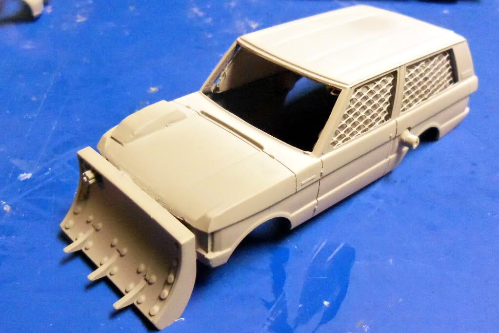

This SUV needed an armored plow, and got one. I think the gun ports on the side turned out pretty well.
comments and questions; post em below.

I am interested in you road.
Could you please tell us how you made it? Like it alot.

I thought I had done a road write up somewhere... hmm guess not   :?  Ok the roads are made from a roll of 3/16" cork. I sealed them with a couple of coats of Modge Podge prior to painting. I then ripped out chunks of road or ripped sections in half, prior to glueing them to Matte board. Glue the pieces back together kinda like a puzzle, but leave gaps for cracks. I put glue + sand and drywall compound along the side of the road, then painted. Primer Grey is the road surface color; I taped off the lines and dabbed liquid latex rubber in spots where the yellow and white go with a sponge. After it dried I painted the stripes with an airbrush. When they dried, I rubbed off the latex gently, and the paint came with it. The whole thing was finished with washes of browns and black on its surface, grass clumps, clump foliage and dyed moss.
Let me know if you need more clarification,
