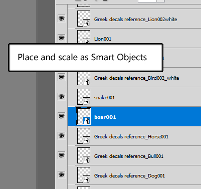

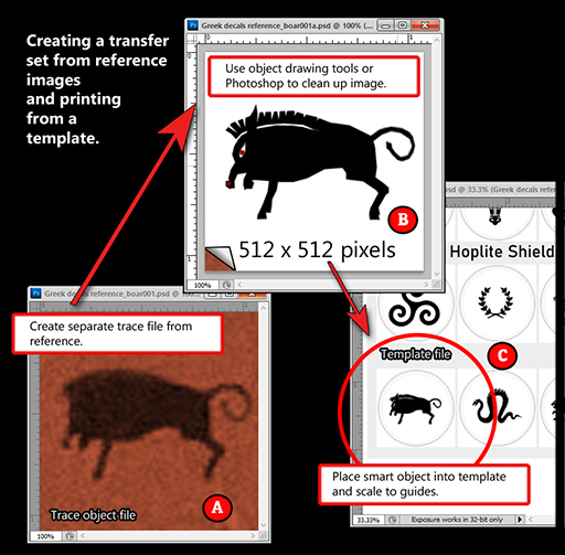

Software:
GIMP is an adequate substitute for PhotoShop (I have an old version of PS and it still works so that's great).
There are a number things that make things work best (PS techniques).
Use layers to keep things separated.
Make you own grid guidelines that can be greyed back on a bottom or top layer which can be locked.
You can make a template guide of the shield outline on another layer if you need it- usually the grid is good enough.
Test print your grid in BW and make sure it aligns with your shields. You can either draw around them, or hold them up to a light and shadow judge them with the paper.
Build you basic art designs in separate files. For example you might want colored surrounds in one file, and symbols in another. That way you have a whole list of your high res images outside the printable document.
In PS use "Place" image (or it may be called embed now) to bring in your designs. Place them as "smart objects" then scale them to fit your grid. You can then repeat and copy and paste duplicates.
The good part of using "smart objects" is that if you decide to update a symbol then you only need to update the original art. Then when you update or re open your PS document the changes magically update.
All this may sound complicated- because it is. But the rewards are high if you learn the tricks.
Properly sprayed and protected home brewed decals are just as sturdy and workable as many  commercial versions. Plus you have control of the design if you need fifty similar ones. I have a big issue getting my LBMS two part system ones to work for me- I reckon that is because I'm a clutz. So I prefer the old school dip them then align them then if needed use some setting solution.

I don’t want to take away from your question to Jeff, but I found this tutorial which would be comparable to making decals for Carthage’s allies like Numidians.
https://mitchwargaming.blogspot.com/2013/03/pictish-shields.html?m=1

That's an excellent other process. Using a bitmap editor to scan into vector is a very useful technique. You can convert rasters to vectors in Photoshop as well but it is actual work.
Having a program like Inkscape is a boost to find, as Adobe Illustrator (my preferred bitmap to vector conversion tool is very expensive).
Having vectors as the placed or embedded smart objects work just as well as rasters- depending on your output. For example for hoplite shields at 10-12mm design radius and my 300 dpi home printer- there isn't too much better resolution to be squeezed out from a 512x512 pixel smart object.
Obviously if these were intended for higher definition, or maybe to be used for 54-60mm figures then I would be investing my time in vectors. But I haven't tried it for those scales as yet.
