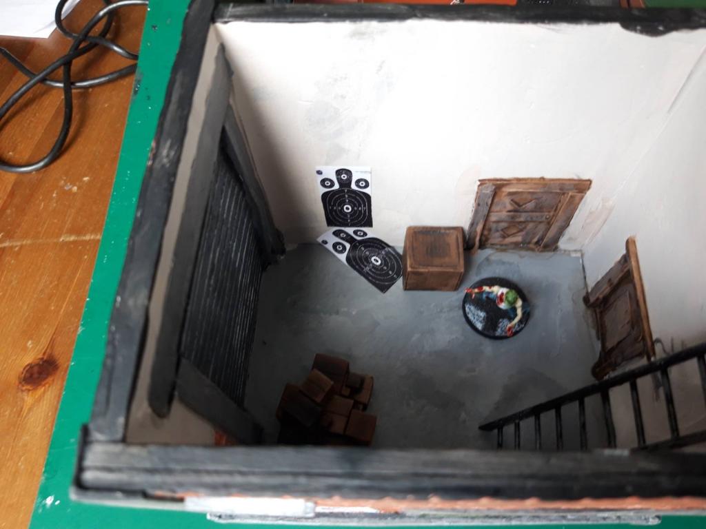

I've been working of and on on this thing. I wanted to varnish the bugger, but my rattle can all but exploded on me. Luckily I ws able to put it aside, while it emptied itself. This meant some delay as I had to order a new one, with all the stores closed.
I did finish some details in the meantime. a display cabinet, which I made with some XPS foam, match sticks, cardboard and overhead sheets. I filled this with some guns from a warlord sprue. I also made a cashiers desk, with a small display, but more importantly, some tin hidden so I could add magnetized mantic bits on them.
I was also bothered there was no ladder. I ended up drilling holes in some coffee stirrers I got from starbucks. I widened the holes with a needle file and put some cocktail stick in them with some pva. Once dry, I snipped of the parts I didn't need. Bit labour intensive, but I like the result and I'll probably be making a bunch of these in the future...
The graffiti ( before the varnish) enden up pretty good. I got some transfer paper that didn't work on Daeothar's printer, but should work on mine, since that was the one he originally bought them for. The transparent stuff did get through, no matter how much I played with settings, but the white one worked fine. Bit more hassle, but I could work with it. I made some extra transfers to experiment with and it ended up working fine, after trying 1 on a test piece. I did end up dabbing the transfer a bit with my finger, to get in all the nooks and crannies, but the big thing was, it got there. It was a bit damaged, but nothing a little black lining couldn't fix, paired with a tiny amount of dry brushing to simulate some wear and tear, with the original colour of the bricks.
I tried a Transfer on the garage door, but it ended up looking like crap, so I was lucky to be able to remove it.
Once the building was varnished I tried to insert the windows. Learning points:
-Openings for windows will, from now on, be in walls with 2 layers. The inside opening will be a bit smaller, so I have surface to apply the window, without gaps.
- Any bars on windows will be attached after the windows themselves are in place.
It took me way took long to cut the things to the right side and I ended up needing to put some more strips on to hide the gaps. The same procedure was necessary on the skylight.
But I ended up finishing the project. The building has 3 entrances on ground level and I figure survivors can get on top by the ladder or drain pipe, allowing for al lot of mobility. It's a great objective to get some guns in a game, or I can remover the boxes from the garage and put in an escape vehicle, making it a perfect stronghold in Last Days.
Not quite sure what my next project is. Feel like some light painting, but I'm sure to soon return to post-apocalyptic sub urban America and get some more buildings in.
