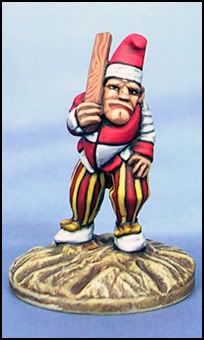

As I always prime black I often take three reds,  dark, medium and light, and mix a little black into the "dark" red for the first layers.
With yellow, I use Foundry Ochre A,B,C, then add further highlights with any really bright yellow I have.
Example below without extreme highlights.
