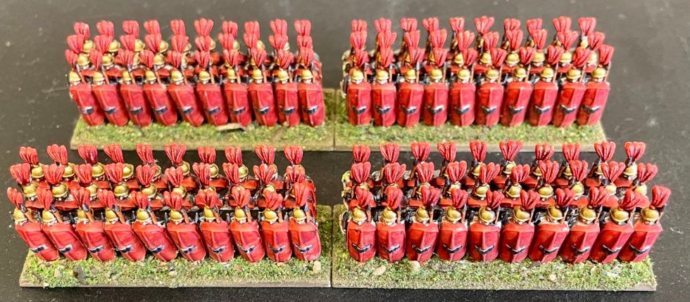

Here's them at the spray primed stage:
The same miniatures painted using my technique with Speed Paints:
Hope this helps!
