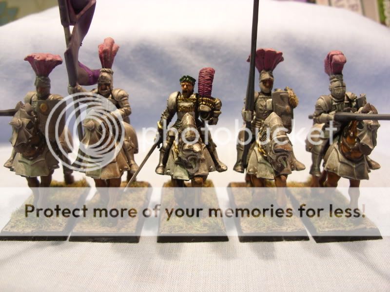

A couple of pics
The champion has been AP Anti shined but I did not use the dip on him and he did not fog
Don't know if you will be able to see the difference
Just previewed them and you can sort of see what I mean, not terrible but annoying

Looking at the picture, I think that the problem is either you didn’t shake the can enough before spraying or you were too generous with the anti-shine spray...
Now… that happen to me once but only on two or three figures… I fear I can’t be of much help since I decided to re-paint over the worst parts and leave the rest as is.

it was the second use of the can, I am beginning to think it was me not shaking for long enough, and being over generous.
Now… that happen to me once but only on two or three figures… I fear I can’t be of much help since I decided to re-paint the over the worst parts and leave the rest as is.
I think that you are right so tonight I will shake the can for britain or at least three minutes anyway.
