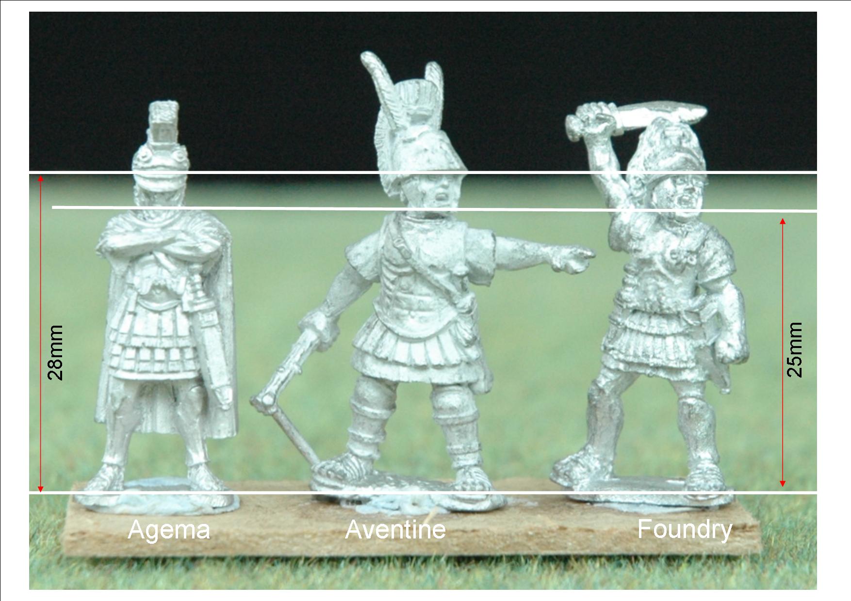

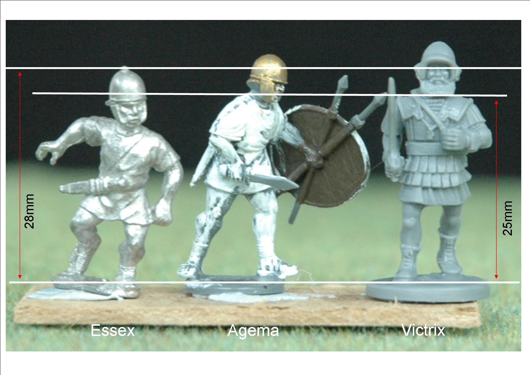

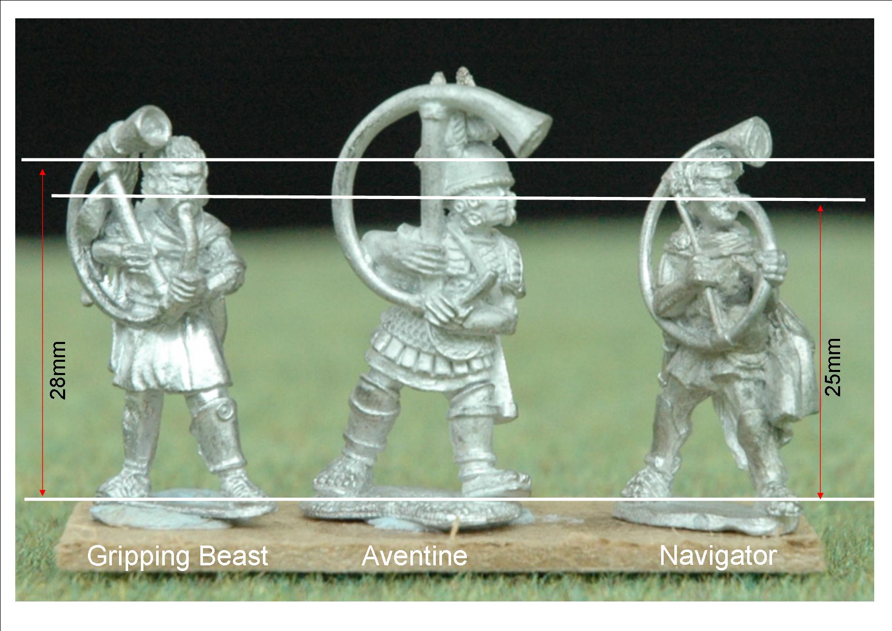

Just discovered 1st (First)  Corps miniatures.    They look great.
  https://1stcorps.co.uk/product-category/ancients/elephants/page/2/
can anyone advise how the figures compare w say Victrix guys   for  scale  ?
A bit late in the day but here are some Republican Roman comparisons:
The rest are on my blog here: click
I use Magister ( Navigator as was) kneeling Triari with my mainly Foundry army and they fit in very nicely. I love the sense of movement in 1st Corps figures. Most of the older metal ranges look short next to Victrix but I find that less jarring than the stylistic difference.
