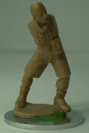

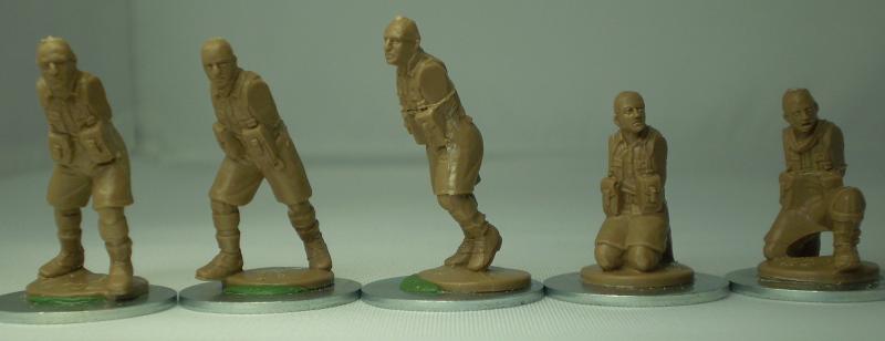

Two glider pilots, for which I've used torsos with goggles, which I think are quite fitting:
And an airlanding infantry section comprising a corporal, six rifles .....
.... plus a lance corporal with the bren group (to which I have added an additional bren team to fill what would otherwise be empty seats):
All have had their water bottles and sword bayonets shaved away.  All are mounted on 20mm plated steel washers.

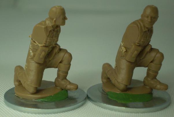

I want to avoid using prostrate minis while having every mini different, so the above include a few 'cut and shut' jobs.  These conversions were very easy to do, using a razor saw just above the pouch lid to use the lower half of a body and just below the pouch lid to use the upper half of a body, while matching up the straps in the small of the back.  This does reduce the number of useable minis in the box, as the resulting spare parts have lost height to the thickness of the saw.
I didn't want to use the grenade throwing pose, so I gave that mini a new pair of legs, cut immediately below the shorts.
