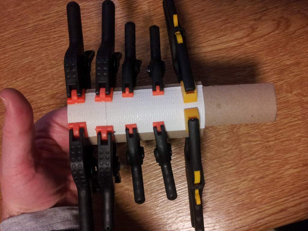

For the curve I've used a finished roll you can find in any fabric shop, they always have them if you ask. Nice and sturdy and come in all sorts of sizes. I simply cut it to size then slapped the brickwork on. Do you think this is overkill?  lol

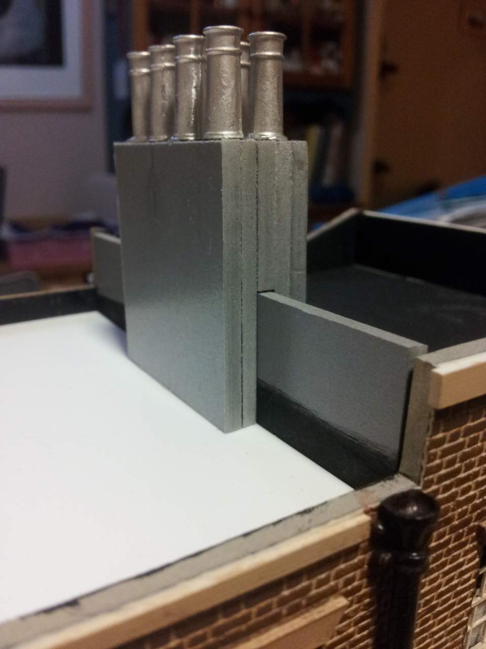

As I said at the beginning of this thread I tend to do things in a cack-handed way. As you can see from this pic I construct the chimney breast by sticking strips of foamed PVC together. This chimney breast is slightly different from the norm as it sits between two roofs of differing heights. The chimney pots are from S&D Models and come with pins attached which helps secure them to the chimney breast:

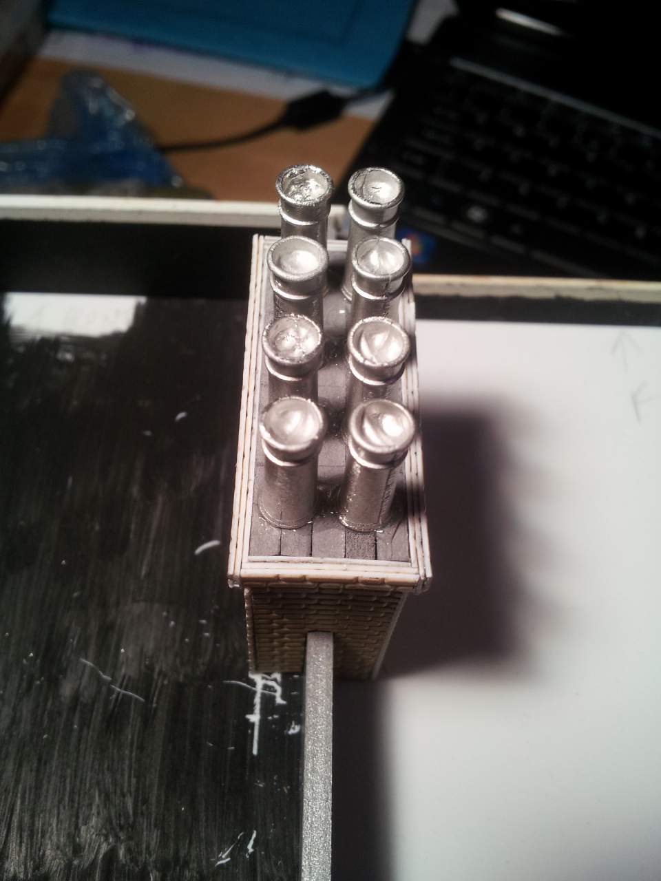

Once I've stuck the brickwork on I then layer it towards the top:
This pic gives you a better idea of what I mean (the top will be covered by Milliput when I come to do the flaunching):
