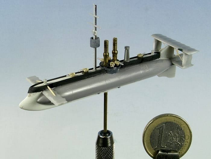

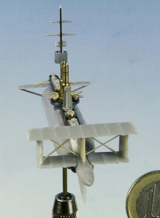

So, yes, it's a lot of work looking for all those tiny suitable bits and pieces. Another four hours later ...  8)
I didn't like the double pumpjacks on the painting, so I found something else in my spares. The gun turrets are 1/35 jerrycan clasps, tiny enough and with some very tiny barrels from streched sprue. The mast is a spare from a 1/700 ship model and I epoxied a piece of thin steel wire behind it for extra stability. Otherwise one incautious action and the mast would have gone. Extra fine rigging at the tail assembly, streched sprue again.
Before airbrushing and painting the thing I have to experiment concerning the airscrews. I want to show just the blurred rotation, so I think I start cutting a circle from transparent plastic and use oils and turpentine. We'll see ...
I think it looks quite like the "Imperator" in the painting, doesn't it?
