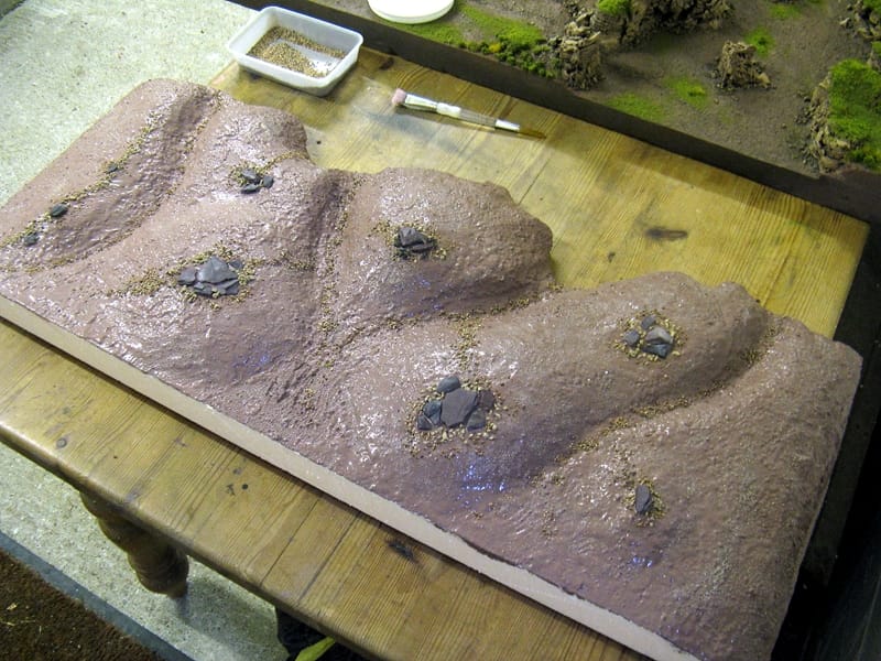

A small update... Works are nearing completion... I nearly said light at the end of the tunnel - but there won't be any. Well, not unless the enterprising cave people can make fire. Otherwise they'll be in the dark...  ;)
First of all, the hillocks on top of the 'lid' are rounded out and blended in using wall filler.
Then, once dry, the whole assembly is given a coat of 'gloop' (PVA / paint / sand / fine grit mix)
Various rocky outcrops are added on the heights (using real bits of slate, surrounded by a sprinkling of 'talus' - model railway rocky stuff).
Scree slopes and pathways have more fine grit sprinkled along.
And finally, whilst still wet, a dusting of sand is added as a surface dressing for a bit of extra texture.
In reality, most of the ground surface will be covered in grass and other vegetation, but patches of bare ground will be left exposed, so the more texture the better.
Once this has dried out and set hard it will be ready for painting and then titivation...  :)

Very promising  :)
It's always best to go to town from the ground up (excuse the pun) as it all adds to the overall effect.
It does, obviously, need to be Crazy Viking-proof  ;)  lol
Velcro  :D
