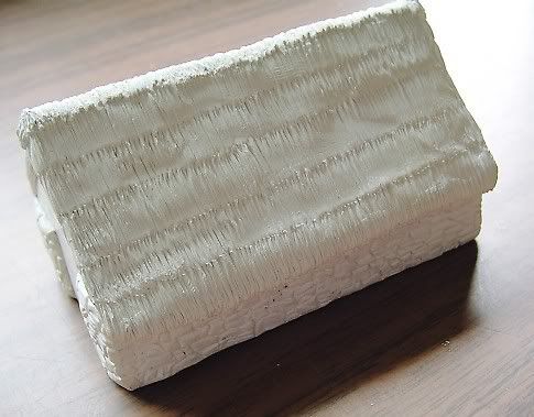

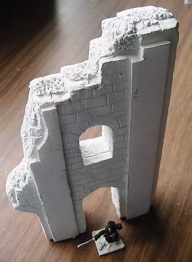

I've seen it used in model making to make building shells, by cutting V grooves in the inner face to enable folding. Through careful design you can also cut out an outer layer and the inner layer using a scalpel to create a tab or flap that will take conventional glues like PVA or even UHU that would otherwise melt the foam in the middle.
I've used it with some success to add bulk to thatched roof sections...
as well as additional thickness for ruined walls etc...
