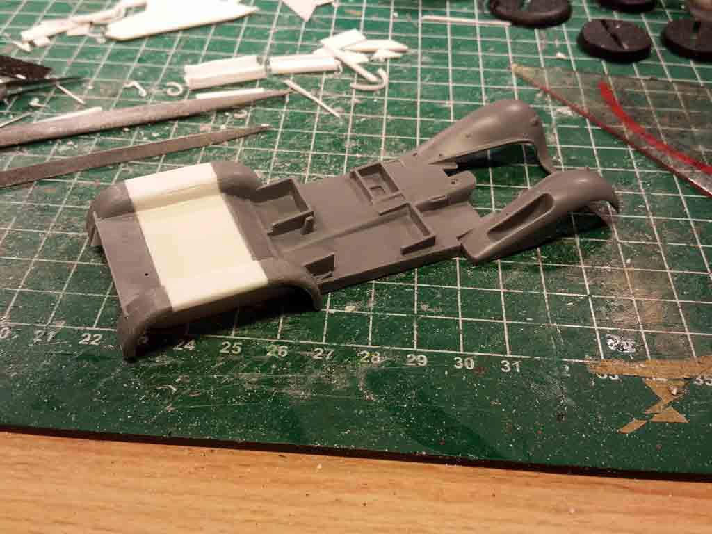

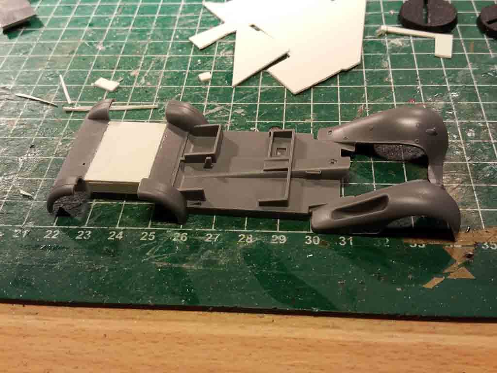

I immediately decided that the most important feature of the staff car, the double rear axle, would have to be converted; it was just too cool and just what a limo needs, when driving around a chunky Patriarch.
So that was my first stop:
Basically, I sawed straight through the chassis (with attached wheel wells), added a length of plasticard and glued the end bit back into place. Braces underneath were used for extra stability and strength. Then the insides of the wheel wells were closed off by first using a bit of card to trace the exact shape required, then that was transferred to plasticard (x2) and glued into place.
The curved fender/wheel well was created by taking a piece of square tubing and cutting it in half, lengthwise. Then the corners were filed into curves to match those of the kit, and after much test fitting, they were glued into place. Then, after letting them dry for a bit, I filed/sanded both inserts completely flush with the original parts.
