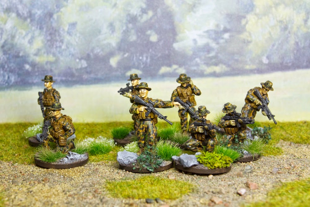

My own exploits have been mostly dotting on colours and not bothering to much about accuracy or the size of the dots. Then giving the whole thing a wash to tie it together. It works for me. Here I have been trying to hit the danish variant of the Flecktarn.
I have seen others achieve great results by sponging on the camo colours. It works great for immitating more modern digital camo.
