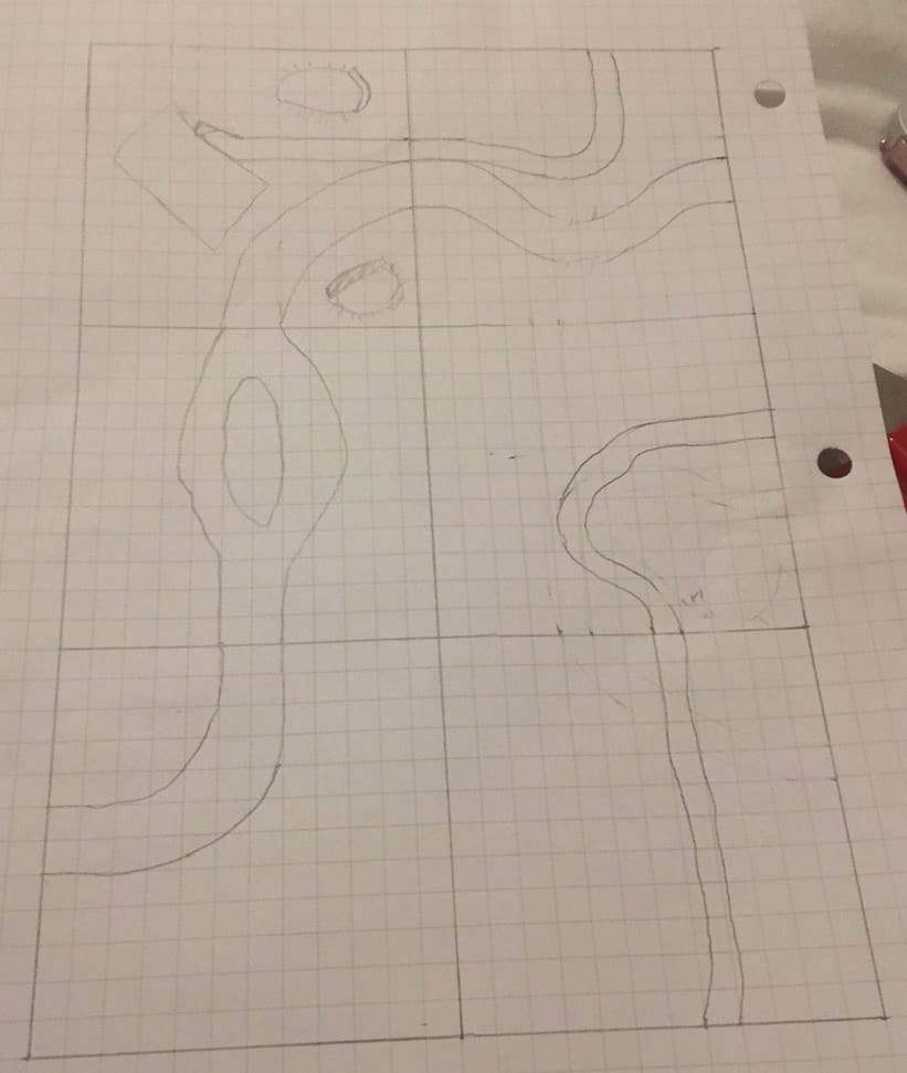

After seeing so many wonderful games at BLAM and with my aborted attempt last year to start some new terrain boards, I decided to give it a go. I'm looking for an 6' x 4' playing surface, which should be more modular than my last attempt. My last board can be seen here

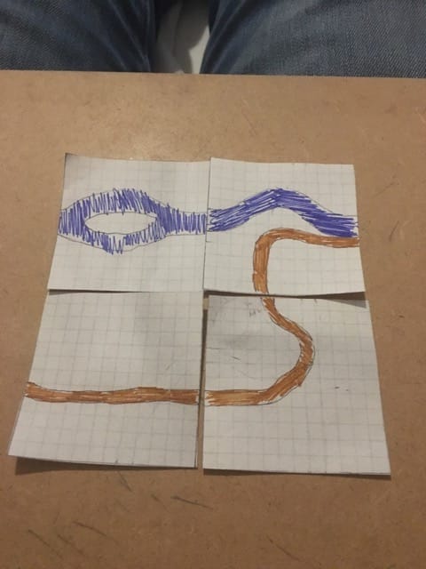

I found some 25mm thick blue foam cut to 600mmx600mm some where online and made the purchase. Albeit this was a couple of years ago and it's sat quite literally collection dust since then. I've decided that I'm going to buck the trend and work in metric! The quick sketch below shows the sample board layouts which I'm going to go for.
One photocopy and some colouring pens later...

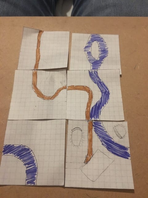

As you can see I've cut each tile out, and had a play around with the different configurations. This is very unlike me, as I usually rush straight into building without any planning. Perhaps I'm learning patience. This is a pretty important step, as I felt that my previous terrain board wasn't anywhere near as modular as I've have liked. As you can see this allows for some interesting combination.
Incase it isn't obvious the brown is a 5cm wide 'road' or track and the blue is a 10cm river. I've not planned any of the topography on the individual tiles yet. I'll probably do that later this evening. I'm also pretty limited in the fact that I've already started to create one of the boards.

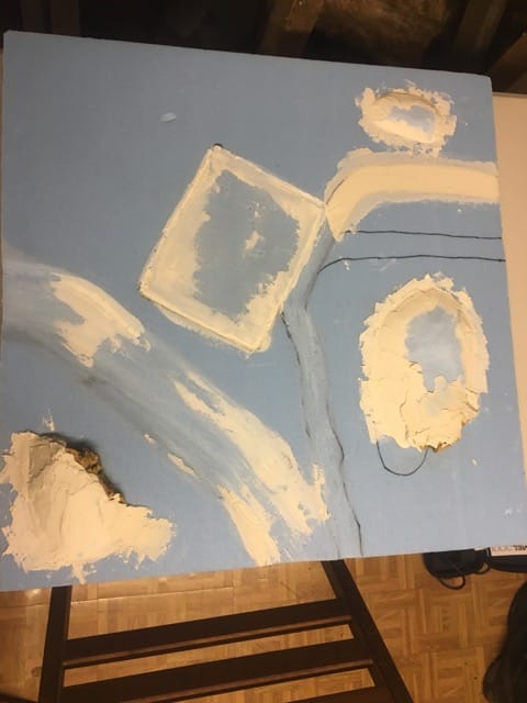

This is the tile that some of you may recognise. It was created last year at some point. Upon playing around with the plans I realised that the configuration wasn't the most modular. I've put filler over one of the sections of road, allowing for greater modularity. Unfortunately this solution isn't ideal... I'm not going to be able to place trees anywhere along this road. You live and learn.
Another technique that I was keen to try last time was sanding a 3mm depression to allow the bases of my buildings to sit flush with the board. I'm not convinced that this is particularly effective- so it will appear on just this one tile. It seems madness to go to all of the trouble of making a board modular to then force yourself to place buildings in the same locations.

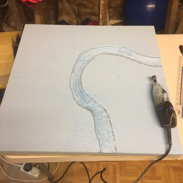

A little update today. Managed to get a lot of the very messy work out of the way.
I always forget how messy this part is! In the picture below you can see the rough sanding of a road. This is definitely not finesse work, and the dremel is your best friend. However beware, this causes a lot of dust. Don't forget a dust mask.

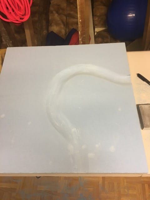

From the above rough cut, I then start to sand the foam to a finer finish. I've found that foam sanding blocks are the best for this. I'll then touch up any stubborn areas with a small piece of sand paper. Please note that the contrast between the track and the surrounding foam isn't that great so it can be a little hard to make out. Oh also the small indents will all disappear when I apply Captain Blood's patented basing gloop (TM).

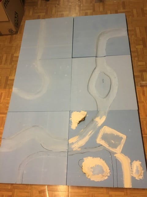

And the entire play out sans any topography. I'm pretty happy with how this is looking just now. I really like the island. I suspect it will add quite a bit of tactical play to games. Please excuse the uneven loft floor.
As you can see I'll need to modify the original board to allow it to better fit with the new boards. The lift at the bottom is cause by the uneven floor.
