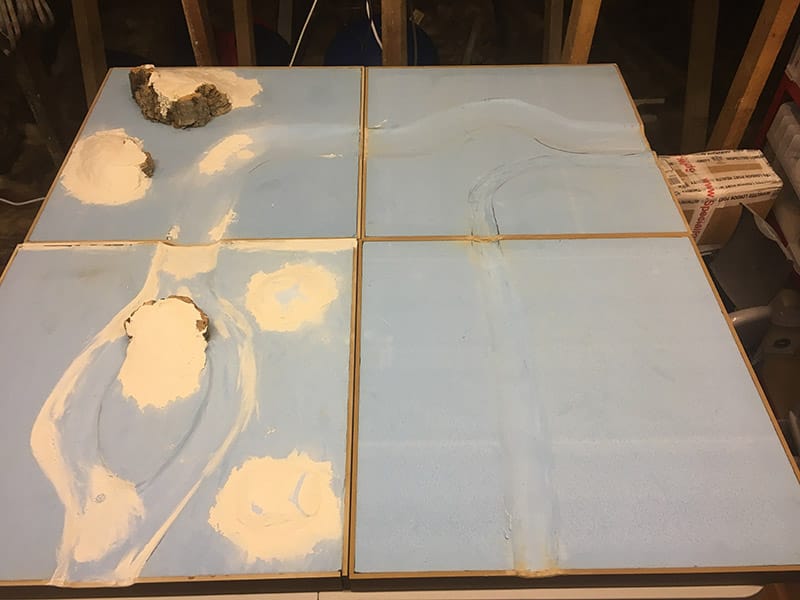

A picture of the boards taken earlier tonight. It shows some of the progress.
The filler on the hills is finally dry! I took a trip down to B&Q last weekend and got them to cut some edging for the board; 6mm thick MDF.
I'm a clumsy bugger, coupled with the fragile edges on the foam, this could prove a recipe for disaster. I've glue the stripping on the protect the board. Some rudimentary sanding later and everything seems to fit together nicely.
I've seen boards with this style of construction, and one thing that I noticed was the gap between the striping and the foam. Since taking the above picture I have ran a very fine layer of filler around the edges of the board. I've also repaired any scratched or marks on the board using it. With any luck it will be dry tomorrow.
Next step is the gloop. This will provide a texture and also lots of additional protection.
Andy

Richard is the man who brought it to my attention. I've ended up with two recipes for the gloop, one of model bases and one for terrain boards.
I use 1 part PVA, 1 part paint and 1 part sand. For models I use a variety of grain sizes, up to some larger pieces that are maybe 5-6mm.
For the board I don't use such a wide variety of large grains. I did in the past and I have found that individual terrain pieces don't sit on it well. I'm currently experimenting with Kiln dried sand from B&Q (I think I'd used sharp sand previously). We'll see how it goes!
In the image below you can see the results of the filler and PVA glue. It's hopefully help to strengthen the boards and prevent it from damage. The PVA will help to make sure that the boards don't absorb as much paint, and I should now be able to spray paint them.
As you can see the gloop goes on quite thickly. All six boards have been covered now. I've deliberately left the depression untouched- this means that I can finally decided whether to turn it into a marsh or a small body of water.
I won't be able to work on them over the weekend. I'm in two minds about the next step- I'm not sure if I should give them a spray undercoat to 'bind' everything together and add extra protection, or just start painting.
Kind Regards
Andy
