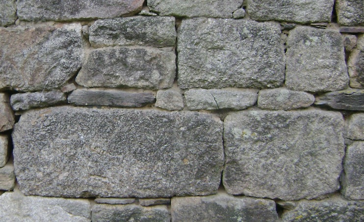

...and your stones overlap properly, as any self-respecting stone mason would have them, avoiding "coup de sabre" mistakes as much as possible. :)
A suggestion for painting: the spaces between the stones does not always appear darker than the stones; for example if the mortar joints are a mixture of local sand and lime they would appear light greyish yellow (as in some parts of this old wall near my home where some very old mortar joints remain - perhaps one day I shall feel self-confident enough to repair them properly, the hole where the sand came from still exists not far away it has been shown to me by a guy whose father did these joints 60 years ago).
Thanks! I really tried to avoid the coup de sabre when building the model. I'm glad you approve ^_^
Noted! Considering my sculpt-to-paint ratio, it will be a while before i paint something with those, though! ^_^
