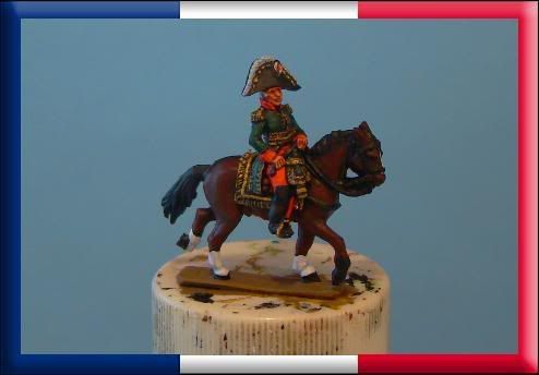

When I have used GW chaos black to prime it rubs off.  As in, rub a part of the figure with my thumb = black thumb; shiny metal miniature.
 :o
What are you doing "touching" your minis?
I mount them on the top of old paint jars.

I don't touch them either.  (I mount them on plastic bottle tops from milk cartons.)  Once primed they remain untouched by anything other than a brush until after they are varnished.  But when experimenting with a primer I need to know that it is tough and durable.  Hence the "rubbing test."
Nice man on horse, by the way.  Good painting.   :)
