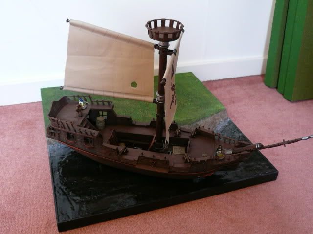

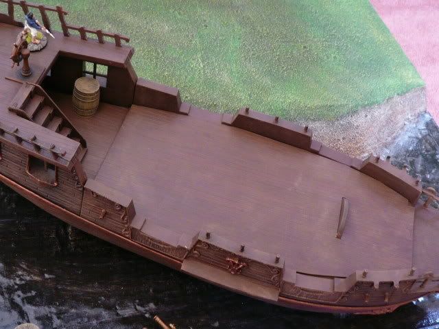

Here are some finished pics of a conversion of Mega Bloks 'Captain Cutlass' Stormstalker (ref 3620) as requested by RaFonaRaFona. The original set is from the Mega-Bloks Pyrates range. Here's the original PDF instructions from the set, to give you an idea.
http://www.megabrands.com/media/playbooks/3620.pdf
The first thing to say is that it was intended for a fantasy game, so there is no attempt at realism - plus I'm a complete numpty on all things nautical - so apologies in advance for any crass misuse of any sailing terms.

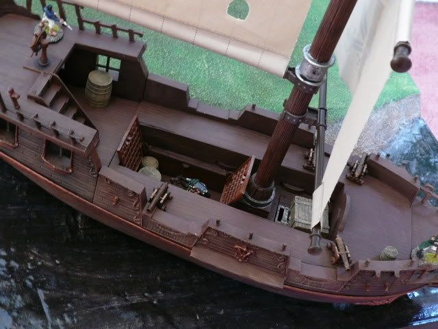

First things first, I removed almost all the 'bobbles' with a pair of GW plastic cutters, with the exception of those securing the stairs and the mast. I also removed the chest\drum on the forward deck and the weird shark figurehead, hacking them away with a knife and sawing where necessary.

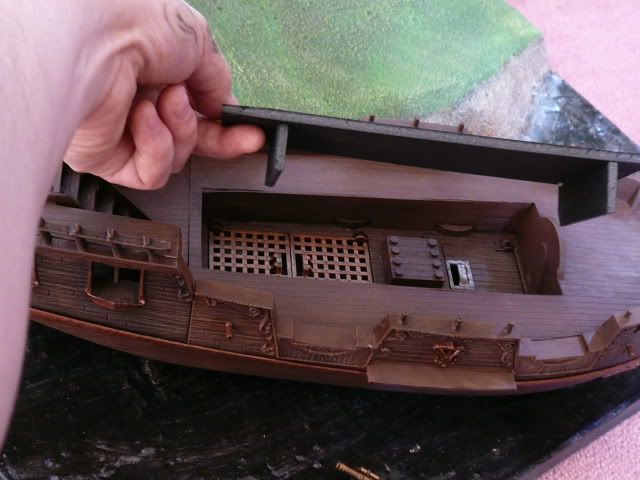

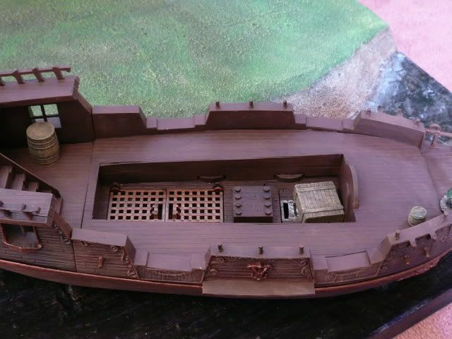

I then spent a while deciding on the deck structure and floor. On the down side, the original model has a number of different levels, few of which would safely house a 25mm base. On the plus side, I liked the depth that the hold gave to the whole thing (and the natty working hold doors) and didn't really want to cover it completely.
So I decided on both! My thinking is that I will get more use out of something modular. For some games, I will want some on-deck battles and the use of a hold meant that there was limited space for putting multiple models on deck.

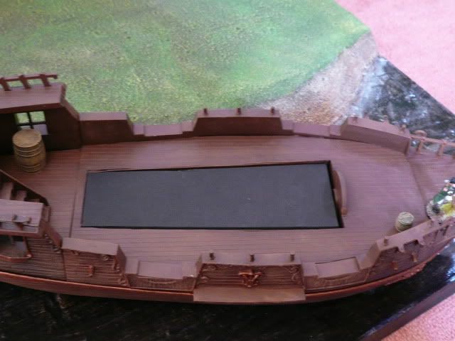

So I built the deck up to a standard level with layers of foamcard, adding with some minor balsa wood additions for the inner walls of the hold. I then built a small foamcard 'table' to fit within the hold, that I could use to support a full deck that I wanted to place over the top.
I still wasn't sure what to clad the deck in. I'd seen balsa strips or carved balsa sections used and also considered using coffee stirrers as planking. I eventually managed to find some very thin plasticard decking and settled on this. While I like the finish of balsa, with my ham-like fists and limited skills it tends to split and I thought personally that it might be difficult to shape it to the deck shape.

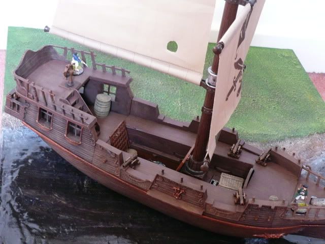

I used the plasticard to clad any visible surface including; the top deck, rear deck (sorry my lack of seamanship is beginning to show), the steps, crows nest and the hold.
For the modular main deck, I made a paper template for and practiced a couple of times to get the right shape. Then the benefits of the plasticard kicked in, as I could simple cut this with scissors to shape. I made two decks, one permanently fixed with a hole for the hold (fitted in three parts which I now regret to be honest) and an overlay for the 'full deck' to sit on the foamcard 'table'.

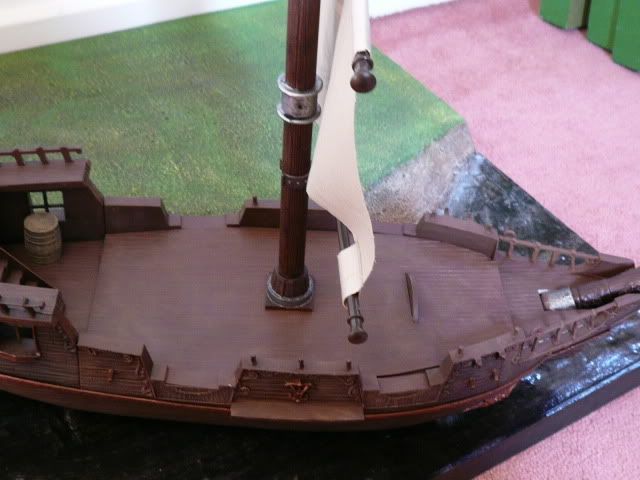

With the full deck version, the mast simply balances on top - I'll probably have to find a better way to permanently fix it, but it will do for now.

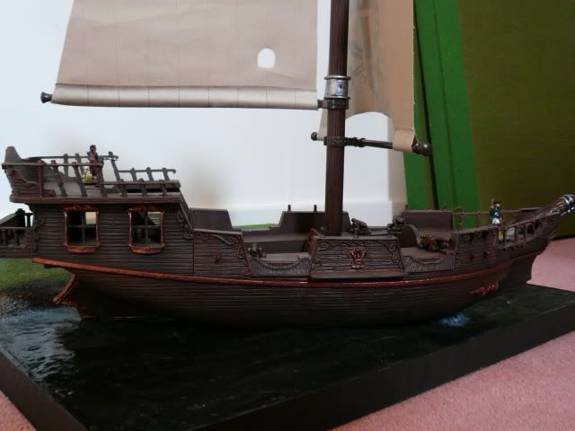

I decided not to use most of the accessories as the distracted from the scale - or were just a bit naff! I'm using the sail provided for now, as I don't have time to source anything else at present. These really bother me, but will have to do for now.
The ship's wheel is from Eureka and was painted and constructed separately and just rests on top on a plasticard base.
I painted the whole deck, hold and mast (thank god for GW foundation colours, as they covered really well), but only washed and dry-brushed the outer hull. Still a few things to finish like the sails and figure-head, but overall it turned out better than I expected and wasn't that difficult to achieve. The Stygian Swine is now ready to sail for the Isle of Dread next weekend!!
