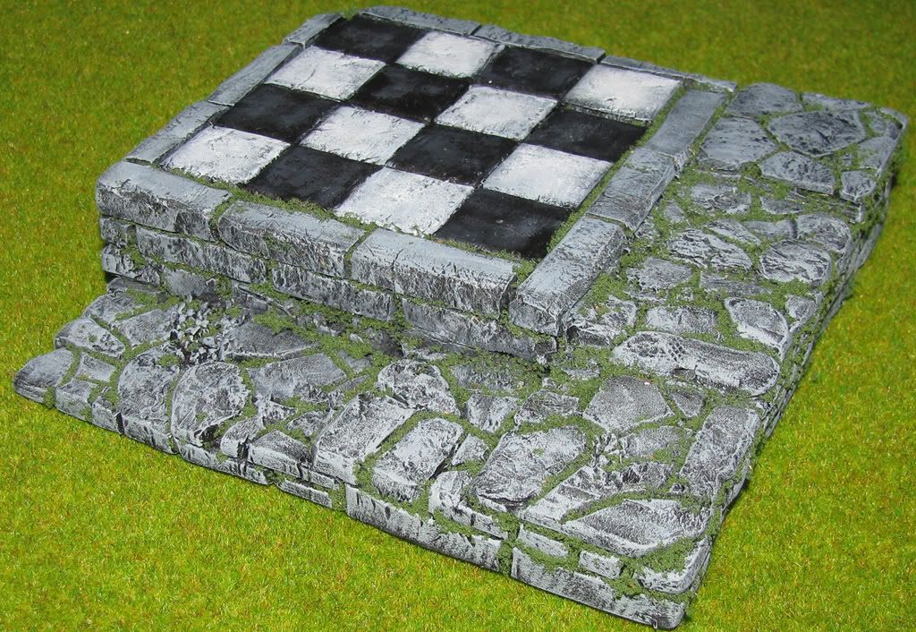

i'm not an expert of styrene carvin, but  it seems a good start! i think you should enhance the lines, cutting them before with a sharpen (more sharpen) cutter, and then using a pencil to open the rift! =)
really, new blades are 100 times better ;)
and if you texturize the bricks with an old stone they will take a much realistic look once painted! :)

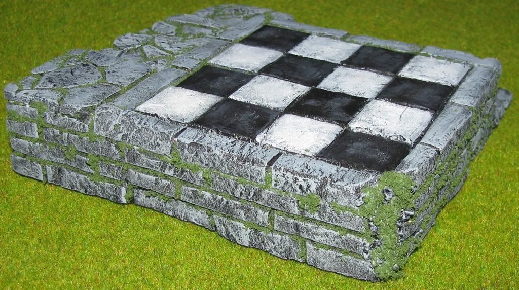

What he said.
Blunt blades tend to tear the foam apart instead of cutting it.
Haven't made much yet, but I did renew my blades rather fast for those couple of pieces.
Instead of "scribing" the lines I cut 2 lines so I got a V-shaped strip I could remove.
pro : very deep lines ; contra : very wide lines, hence the large amount of weeds between the stones.
I also used the rock surface detail trick :
i wouldn't do that, the pencil is a good way. but if you make one cut before you will have a more definite stone! :)

before starting to scribe the bricks/rocks, you could press a suitably rough small stone into the foam so to obtain a less regular surface.

And about painting styrene? How did you paint that zizi?
Offline zizi666
  • Posts: 3558
    • My Photobucket page
Re: Faber's Ambitious Mordheim Project [PICS HEAVY]
« Reply #25 on: 02 May 2011, 04:16:55 PM »
I covered it completely in black acrylic paint (rather thick stuff from those large Windsor & Newton bottles) then painted it dark grey and drybrushed with lighter tones of grey.
...and if you add a tip of blue (and maybe some brown on the first coat) you will have a more fantasy-dark-like colour!

have you tried to use an electrical drill (a cheap one is enough) to carve the bricks in the blue stirofoam!
I've used that with balsa wood to draw bricks and liked the results

A tip on how to weather and roughen up carved foam stone faces:
Crumple up a sheet of aluminum foil into a ball, roll it around a bit on a cutting board or similar to smooth out the pointy bits a little. Then roll it over your stone work, applying preassure from above with your hand. It really works great!
