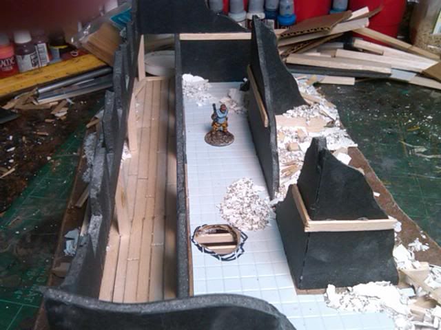

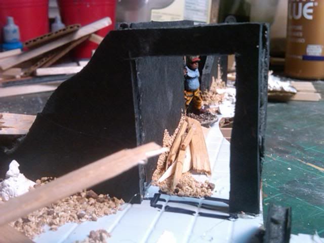

I've started a new ruined building for my Fallout project. It was roughed in in about 4 hours over the weekend.
28mm scale. Large ruin with second story, and lift off second floor for access to interior. Access to second story will be to climb on rubble and collapsed floor.
Its made from stuff in my scratchbuilding boxes:
Balsa and Bass wood(random bulk bags from Hobby Lobby)
Single-Ply Carboard (from packing boxes)
Cocktail sticks and shapes
MDF base
Vacu Formed sheet textures(for tile, etc.)
Gatorboard( similar to foam board, but instead of paper sandwiching foam, its a thin hardboard sandwiching foam. ten time stronger than foamboard, but harder to cut.)
Hot Glue
Tacky Glue
Scatter and Rocks and whatever for rubble

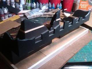

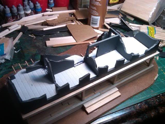

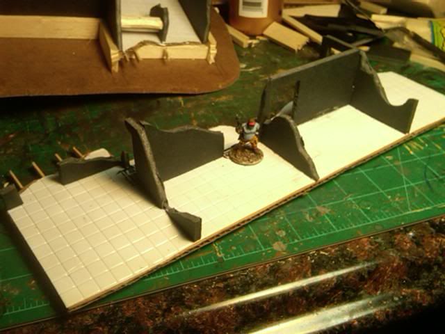

Before adding the exterior walls to the base.
All exterior walls secured to base. Front.
All exterior walls secured to base. Rear.

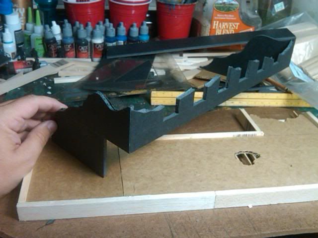

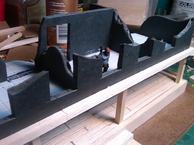

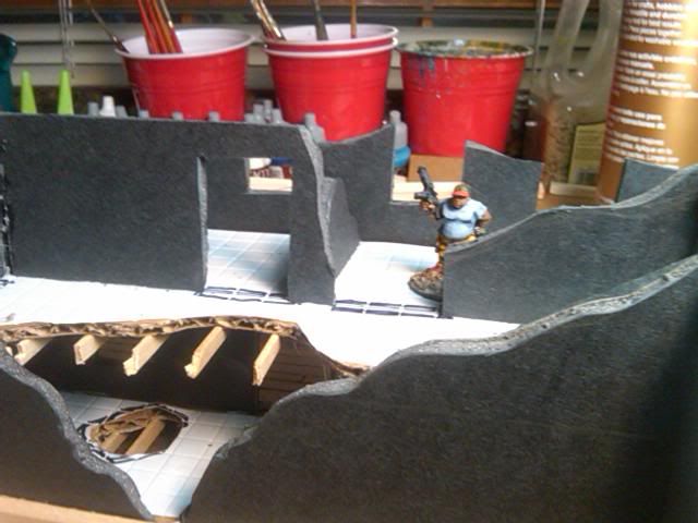

Lift-off second floor removed from building.

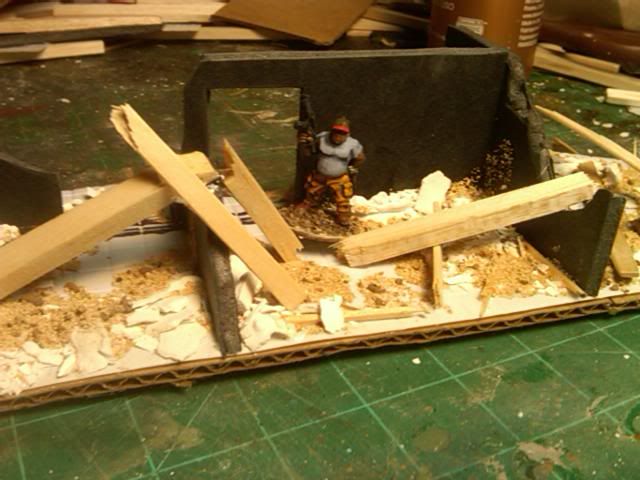

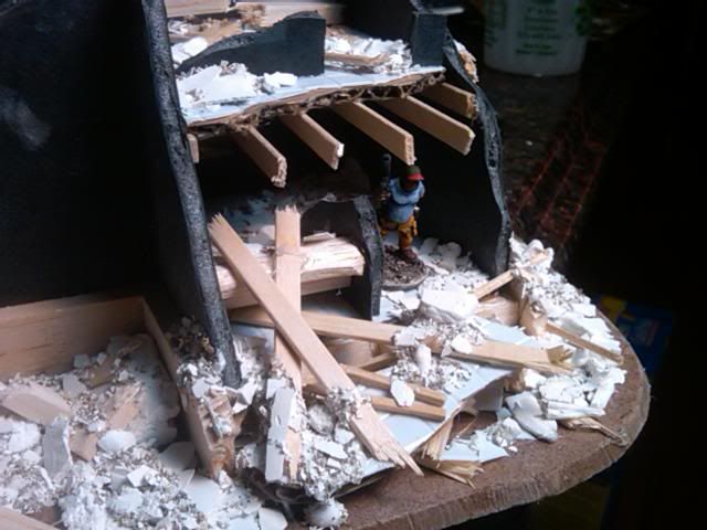

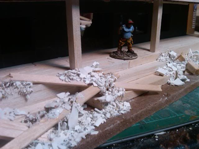

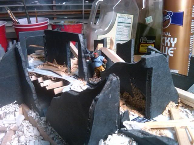

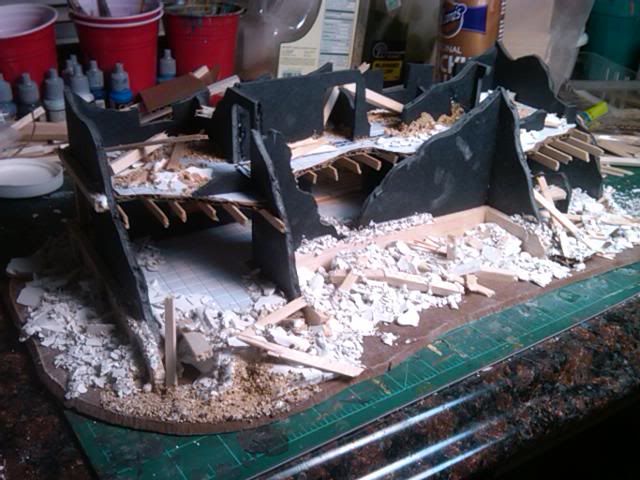

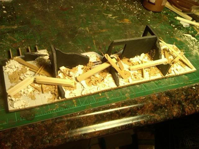

Here's an update after a good nights work rubbling out the building.
Plaster, sand, kitty litter, craft sticks, and glue.
Front Overall
Rear Overall
Front Porch
Interior First Floor(kept relatively clean for fig movement).
Lift -Off Second Floor Overall
Lift -Off Second Floor Detail
Detail
Detail
Detail
Priming is next. I will hand prime with latex house paint. Then successive dirty washes, and dry brushing, etc. Then some static grass

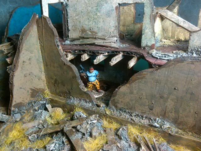

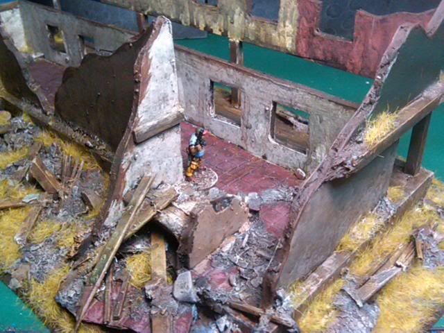

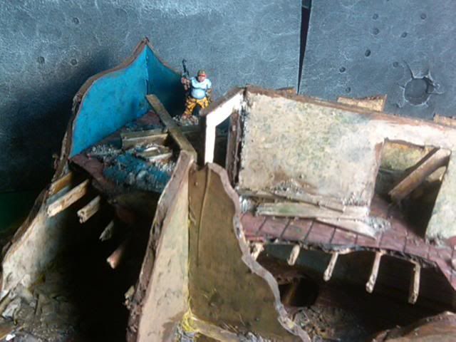

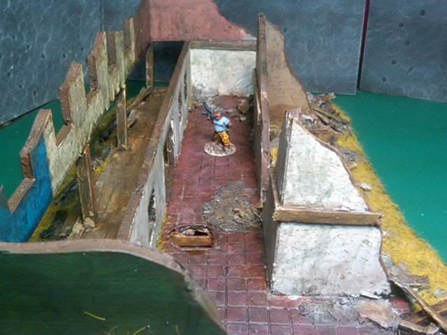

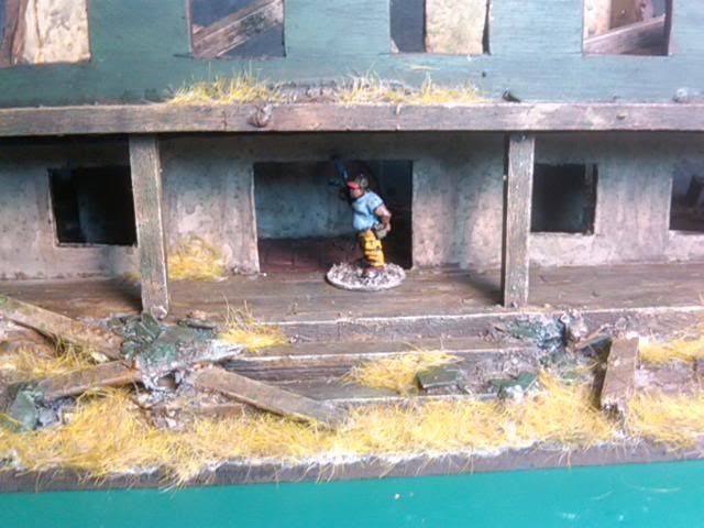

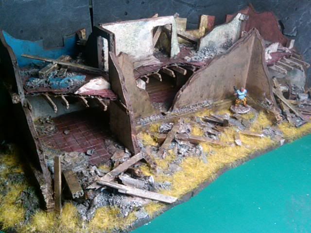

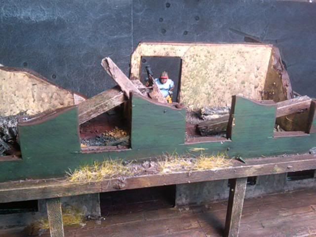

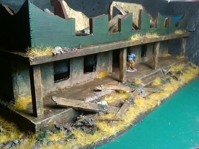

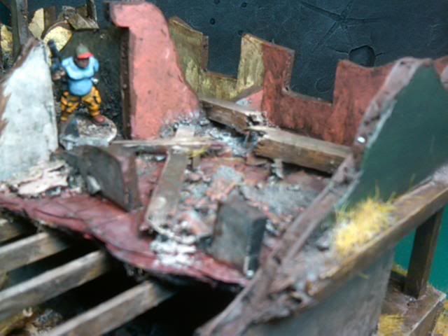

I finished the building with a paint job and washes that took an evening. I am pleased that Building #3 is complete. I love doing the finishing work on these things.
I base painted the walls and rooms first, then rubble. Then highlighted everything twice. I then mixed up a black and a brown wash (craft paints, water, jet dry, little bit of ink). I wash the already highlighted areas, let dry, wash again, let dry, then go back and pick out detail, etc. Paint ground plain, add static grass, then its complete. Hope you enjoy.
Overall - Front
Overall - Rear
Detail - Front Porch and Building Entry
Detail - Front, 2nd Floor
Detail - Rear, Hole
Detail - 2nd Floor
Detail - 2nd Floor
Detail - 1st Floor, with 2nd Floor Removed
Detail - Stairs on 1st Floor with 2nd Floor Removed
