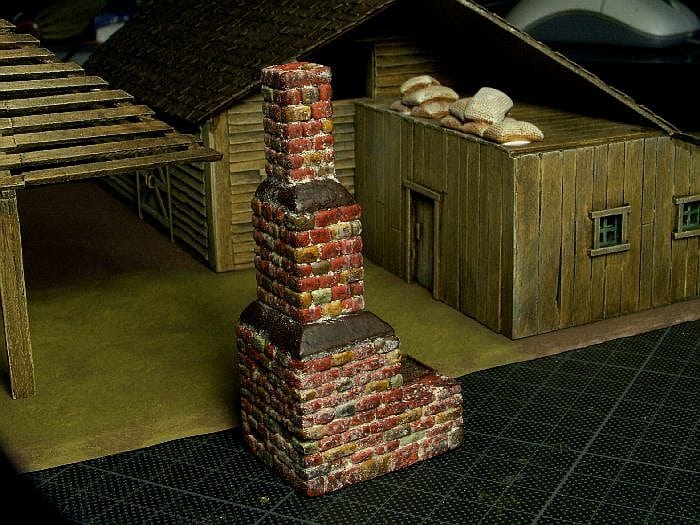

Finished the grouting on the chimney using pastels and isopropyl alkohol; works nicely including a good weathering effect, I think:

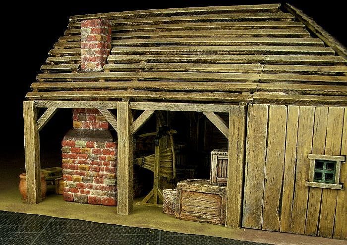

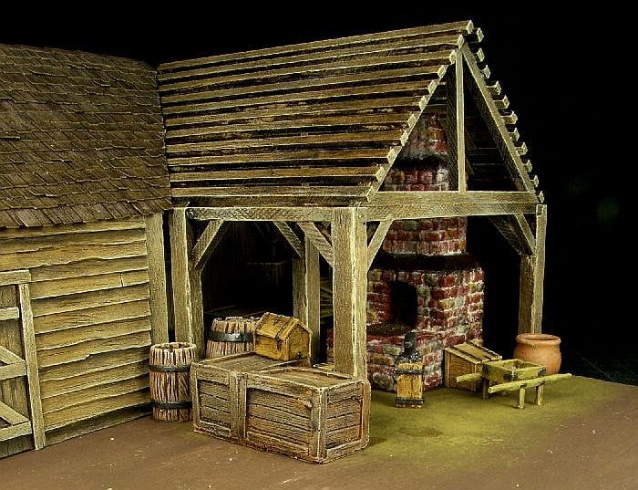

Everything of the workshop was then glued down firmly, a slightly hazardous action as both the roof construction and the chimney AND the bellows needed to be placed simultaneoulsly. All accessories were then added from back to front. Small detail items like hammers, tools etc. will follow soon.
The plan is to leave the roof partly open, as if it would be in the process of getting new shingles. So I will use a slightly modified colour for those shingles, looking a bit more "new". This way I'll get more light into the workshop ...

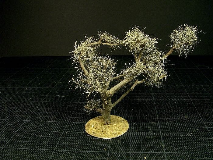

I want to include some nice trees to the farm and church and some more for the table, so I had some prepared. I think it's most important to find some nice and realistic looking twigs, and for me the best and most durable material for the small branches is rubberised horsehair. Tearing the stuff apart and cutting small pieces to be glued down with woodglue is the first step. This is what you see here, too much material:

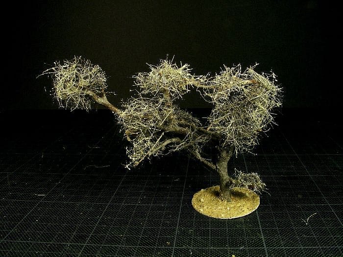

When the glue is completey dry (leave it overnight), start to cut and tear the stuff with scissors to thin it out and try to get a realistic branch structure. I did it here on the next pic, but even after getting this photo I cut more horsehair down for more "fluffyness".

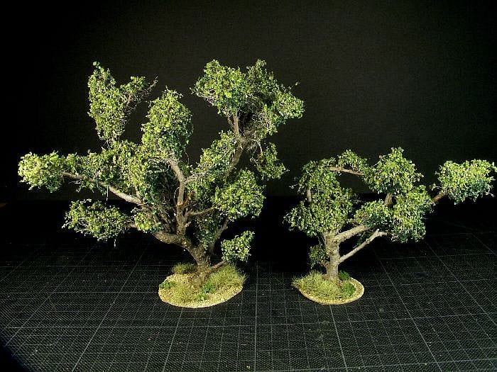

Then on to scattering the branches with two different coloured materials, a dark one from below, and the light tone from above. Similar to painting a miniature ... And I will heartily recommend to not use hair spray, spray glue, wood glue or whatever, but the one-and-only-glue for all scatter materials - Scatter-Grip, available from Antenocities Workshop. The stuff is as sticky as it gets and will not harden but remain sticky, so what will come into contact with this stuff will stick forever! (Including fingers, tweezers, toothpicks and of course other trees, so keep them separate; I use cheap freezer bags)
For me those trees look as natural as it gets on a wargame table, and they can stand some handling, too. There was a left-over piece from cutting the trees apart, and instead of throwing it away it was converted into a small woodcutter scene. Could be used as objective marker or something like that.
