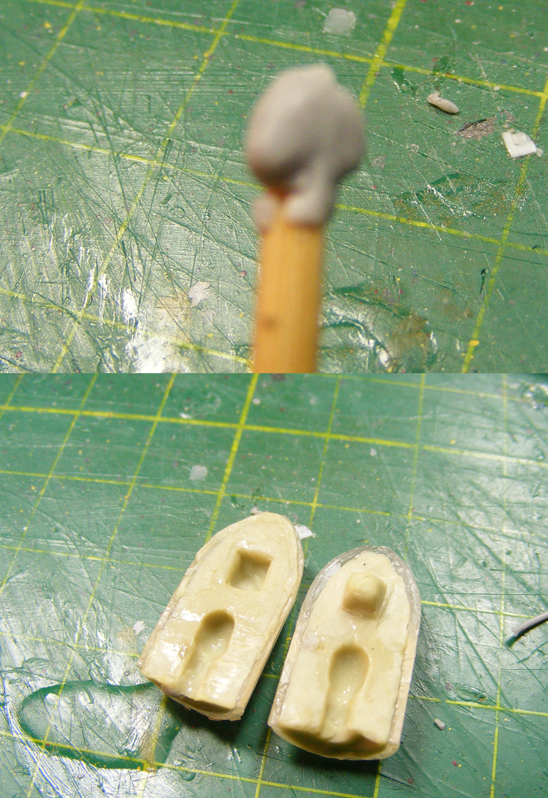

Little Advice for the head problem. To avoid to make mistakes in the basic shaping or size of a head make a standard! Once upon a time far far away 12 years ago I´ve sculpted ONE Masterheadshape to predefine the size and Basicshape. After it was finished and cured I´ve made a pressmold with Magic Sculp and Vaseline. Magic Sculp is perfect for that, because its very soft in the beginning and ended up Rockhard. In the way I did it you can use the not finished used amounts of putty that are not yet hard, but to less sticky to further work with it. Weting you mold, put the Putty in press the two halfes together and then push a Toothpick or Kebabstick through the hole in the Bottom. That presses the Putty perfect in the mold and stick to the Kebabstick. Take it out and let it cure. Its the perfect Base to work on and you have never ever leavings of unused Putty to throw away.
