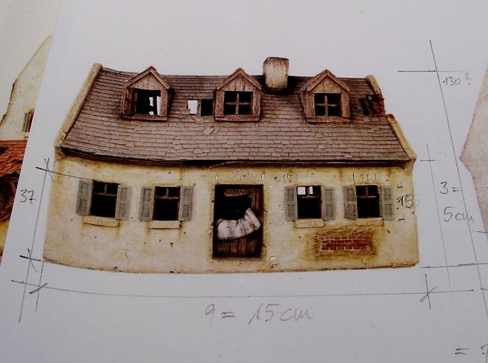

So where to start? How to get proportions right, and how to come to some useful measurements? I started to scan the web for contemporary drawings and pictures of similar buildings from the area and found quite some useful stuff. I was even more lucky as the US company "First Legion" did those exact buildings from the painting for their 54 mm range of historical miniatures for collectors. Some of their pics were downloaded and then printed and I could start some exact measuring and calculating to find a ratio to transfer the main features of the buildings to about 1/60 scale.

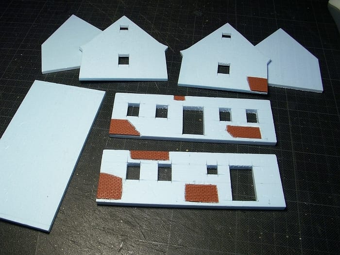

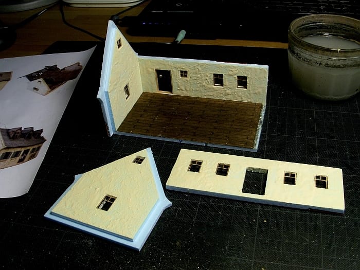

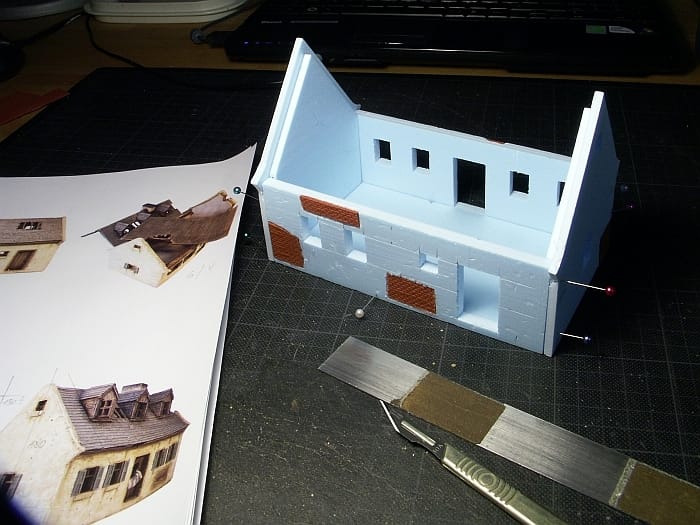

My drawings were transfered to 5 mm foamboard (Styrodur) and cut out. The gable walls were cut from 3 mm material as they must be sandwiched from two parts to get a supporting frame for the roof. All parts were only fixed with needles during this stage of the modelling, not glued together.

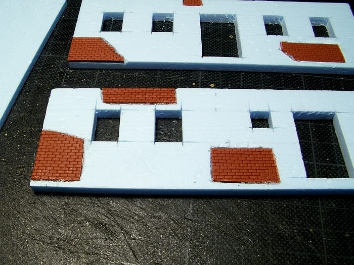

As you can see some pieces of plastic brickwork were glued into pre-cut slots where the plaster would be chipped and brickwork visible. I used I used WILLS 00 scenic materials plain bond brickwork for this as it's very niceley cut and modelled and superior to other brands for my taste.

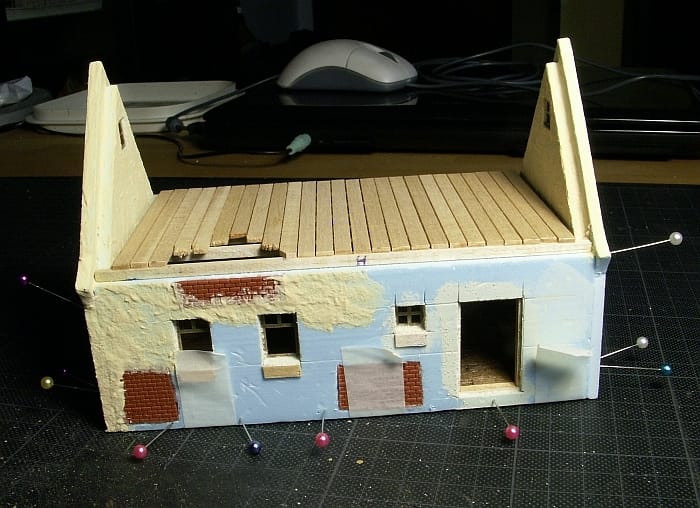

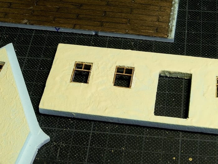

I scribed a wooden floor into a thin piece of balsa, glued it to the house's floor and painted it with some dark acrylic stain. The inner walls got a coat of thinned down plaster-with-paint-mix as they would not be easily accessible when glued together, and some nicely laser-cut windows from Andy Slater had been prepainted and glued into the openings now. Then all walls and the floor could be glued together, fixed with needles again and left to dry thoroughly.

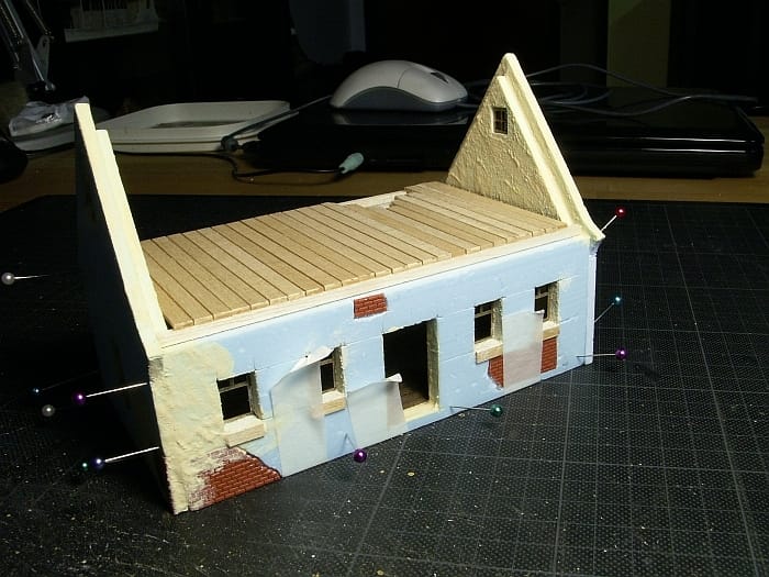

The last two pics already show the removable attic floor I build from wood strips. The model will be fully accessible later for placing miniatures inside firing out of the windows and from the roof openings.
So far for today. Next time: the roof construction ...
