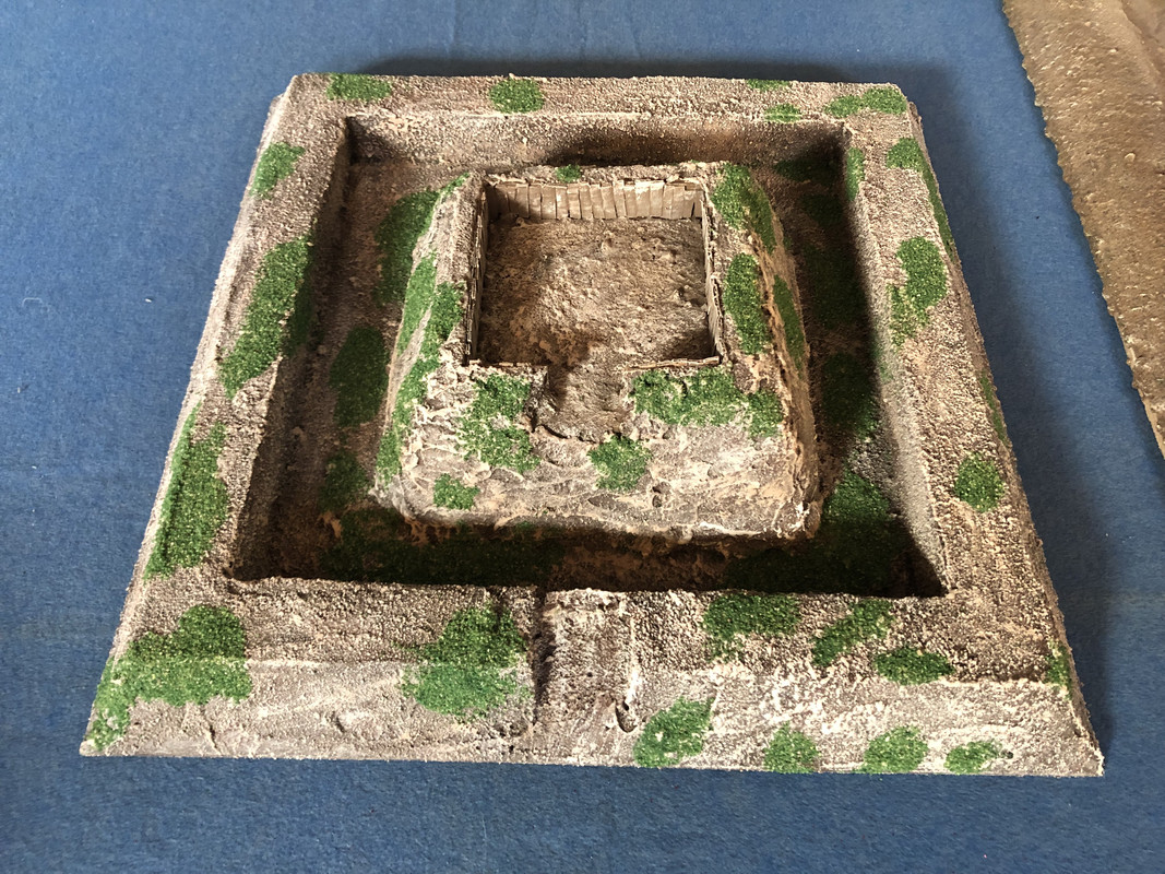

I built one out of blue insulation board in 15mm
It is designed to work with the basing system of the Tercio rules. A step-by-step can be found here;   https://epicureanwars.blogspot.com/2019/11/this-message-has-not-been-approved-by.html

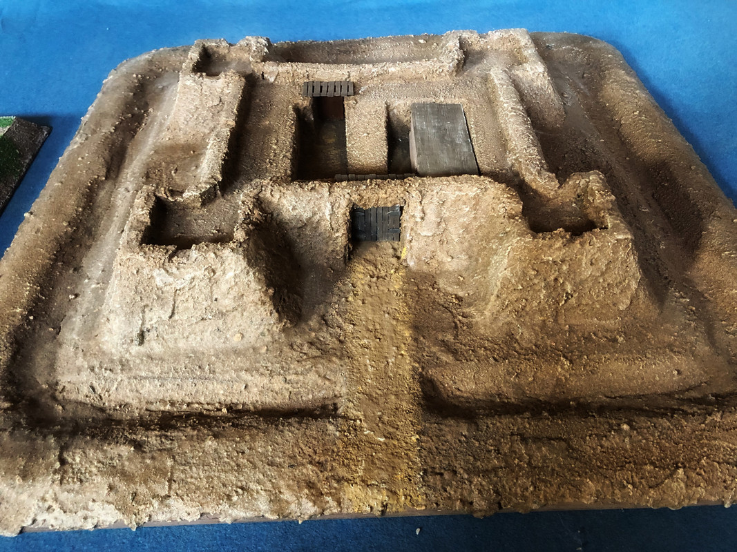

I made a few but actually not used them much in games. The bigger they are the harder to fit on the table:
I have not fully finished these, they could do with some gabions and some debris etc but they are quite cheap and easy to make:
-Plywood or mdf board in the bottom
-EPS, or preferably blue, foam
-Wood glue
-Sand
-Paint
A wire foam cutter makes it easier to get the right angles on the ramparts but since you cover it all with glue and sand you can cut it with a sharp knife: look forward to see your progress!
