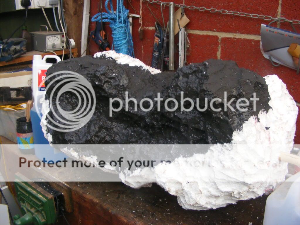

While i sort some pics of the current asteroid, heres a pic of the first one i made. It worked well, but was not very playible for various reasons. The new ones a bit more smoother and has a intergrated stand.

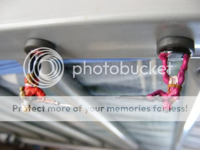

in the mean time, heres a pic of a Martian and a Englishman upside down:
This is stuck to beam of my bed which is steel. Hopefully I can achive the same attraction on the stroid but if not i will just swap the mags out for more powerfull ones.
