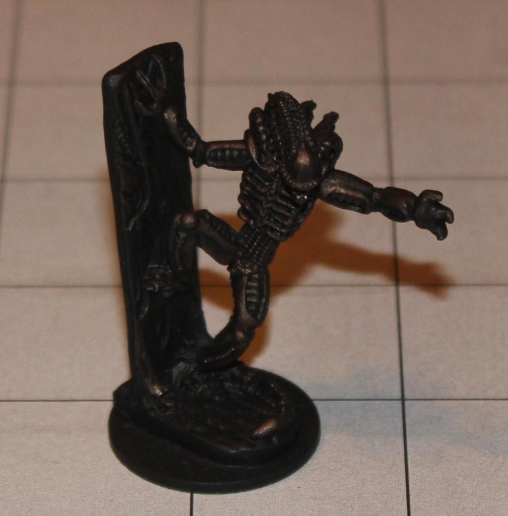

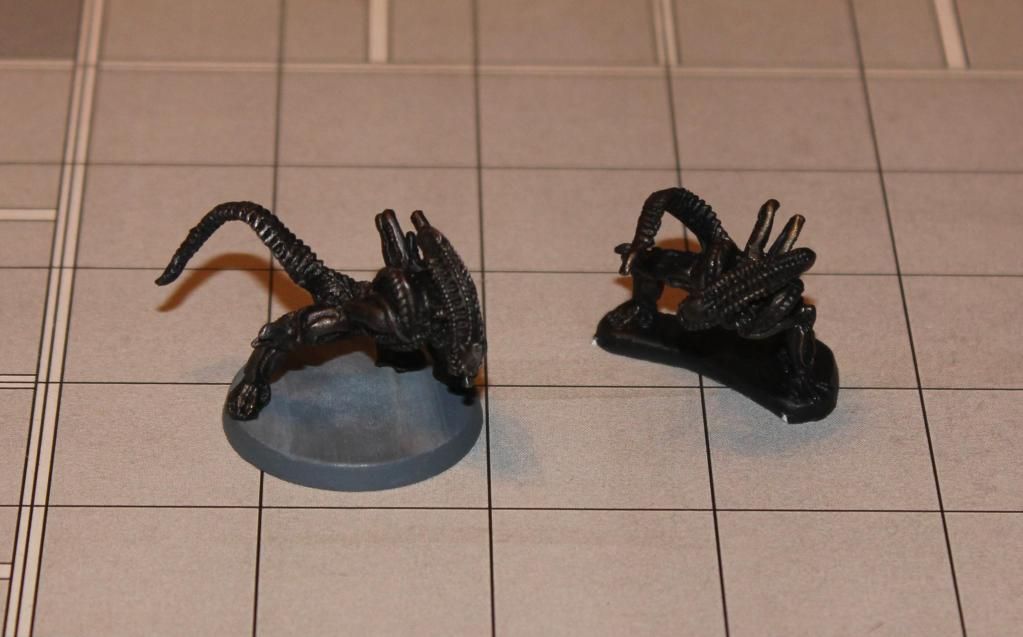

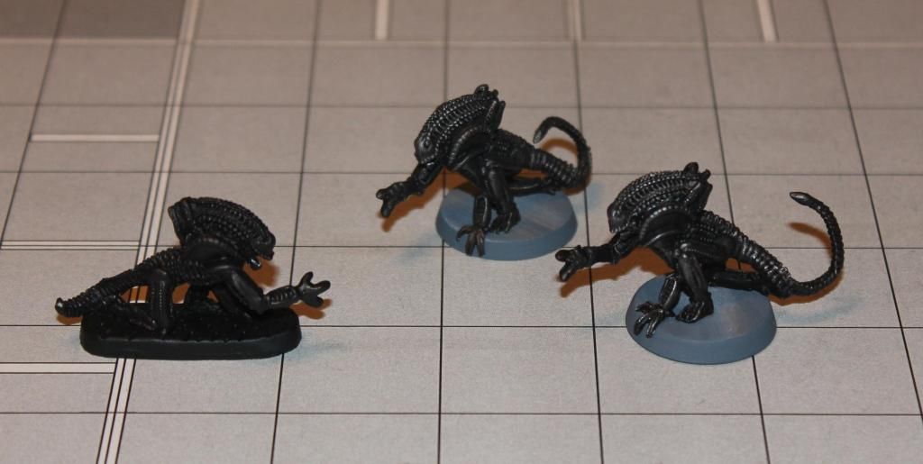

There are a few of the Leading Edge Aliens that just don't work as gaming miniatures. When I started my re-basing project I left all the difficult bases for last. Well now I'm nearing the end and I have to figure out what to do. One of the most annoying is the stalking Alien. The miniature is attached to a 36mm long integral base. The pose isn't so bad but the big chunk of lead base under him makes it really hard to add a washer. For the stalking alien I cut off the base and pinned him to the new slotta-base by the foot and knee. This left one of his hands sticking out over the edge of the base. I figured out that if you trim the hand down enough you could bend it so it looks like the alien is holding onto the edge of the base. I was so pleased with the results that I started in on the second on right away. After doing the second one I'm not in such a hurry to finish the third. I also have to reattach the tail to the third stalker. It was broken off during the game that inspired the whole re-basing project.
The second annoying one is the crouching Alien. The biggest problem here is the sheer size of his base. I just had to use a bigger slotta-base for this one. I'd be more annoyed but this sculpt is pretty cool. I only have two of this one, so he gets to be special.
Now I have to figure out what to do with the surf board Alien.
I think he looks nice as is. I left a couple of Horrorclix Aliens like that. Sure, they look a bit daft if used outdoors in games, but they work a treat in Space Hulk etc.
