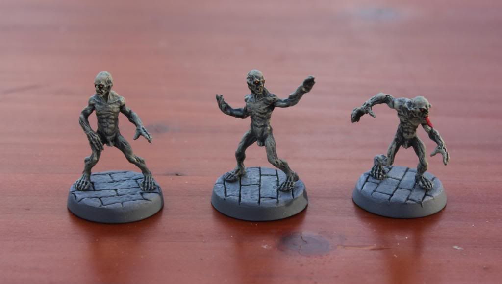

For about three years now I've been basing my fantasy figures on 30mm rounded edge bases with vinyl cobblestone matte inserted into it. It comes out looking like this...
Recently I decided I didn't want my figures on such big bases. This meant I would have to make some new bases. It was time to learn how to use green stuff. The results look like this...
These are not the same figures. Just the first batch of Otherworlds Ghouls to get the re-basing treatment.

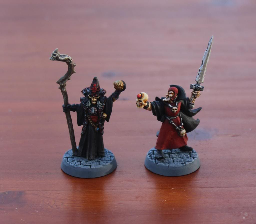

And of course other undead leaders had to be re-based as well. At least these guys had decent paint jobs, and thick ankles.

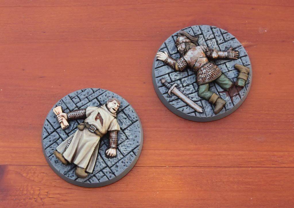

One of the great advantages of making your own bases is, you can do neat bases for special figures, like Slain Adventurers...

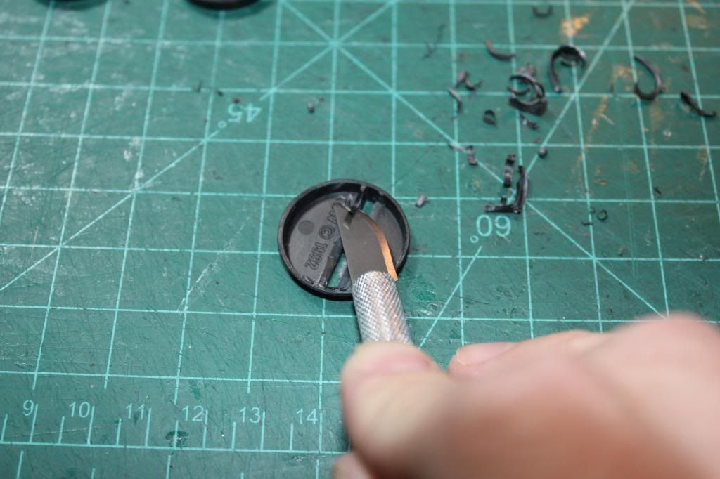

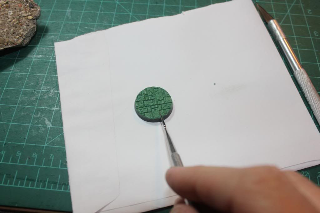

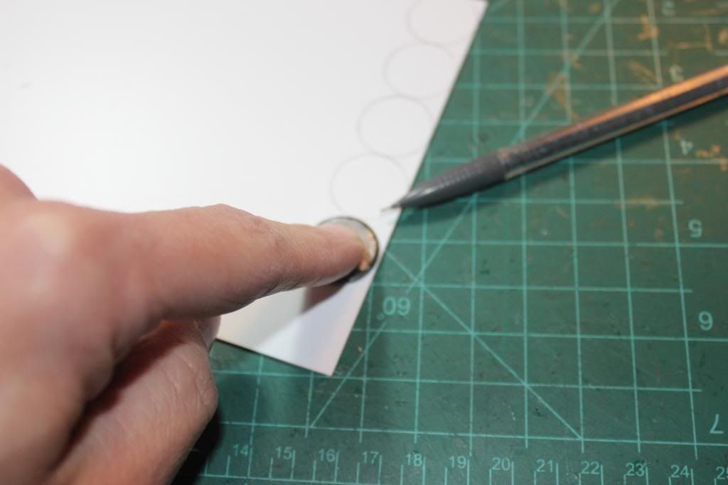

As promised, how I make my bases.
1. Cut the slotta supports out of the slotta bases. Trim around the inside edges of the base so the washer fits inside the base in step three. (Don't forget to scrap off all the logos and other unnecessary printing inside the base.)

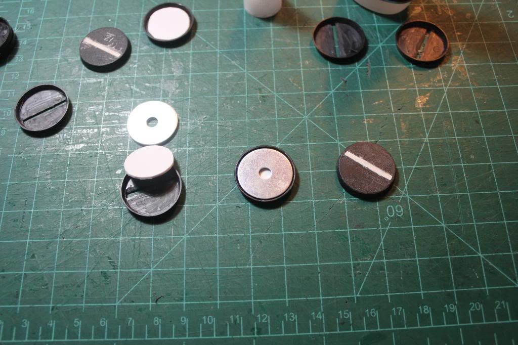

2. Draw a circle around a 3/4inch washer onto a piece of .040 sheet plastic. This should fit inside the top of a hollowed out slotta base.
3. Glue the plastic circle into the hollowed out slotta base. Then glue a 7/8th inch washer on top of the plastic circle inside the base. Flip the base over and putty up the slot on top. Wait for the putty to dry. The washer provides weight to the base, and gives the base something to attach it to magnet sheet for transport.

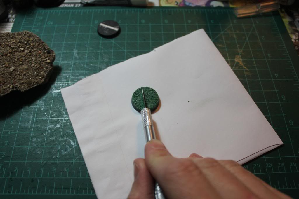

4. Mix up some green stuff. Then press it in place on top of the base. Flatten the top on wax paper or other non-stick surface. Trim the excess green stuff from around the edge of the top of the base. (You have to trim that edge a couple times throughout the process.)
5. Press the smooth green stuff topping onto a chunk of concrete you find in your backyard (or garden if you live in the UK). Lift and repeat till you're happy with the surface detail. Do NOT leave the green stuff pressed into the chunk of concrete too long or it will stick to the chunk of concrete.
6. Cut a pattern into the surface with an X-acto knife. Be careful, blood and greens stuff don't mix well.
7. Wait a few minutes. Then follow the X-acto lines with a sculpting tool blade edge to widen the groove.
8. Do one final trim along the edge and that's all there is to it.
There are many better ways of doing this, I'm sure. And not everyone needs washers sunk into their slotta-bases like I do. I'm sure there are a number of real sculptors who are cringing at this process, and I can't blame them. This is my first sculpting project. I'm just showing off how I make these bases.
« Last Edit: March 29, 2018, 03:31:59 AM by Michka »
