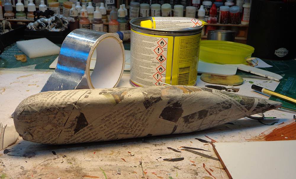

So, the wooden dildo is clad in GladPac and strips of newpaper glued in a few layers onto it. Since I am going to make a broken apart fuselage, I need a hull with  fairly thin shell. Next, I am about to sand it and add a layer of spackle.

Thanks, chaps. It's a bit learning by doing. It was not enough to oil the dildo, the glue is very firm and stuck to the block. I had to rub the thing quite vigorously to shed the skin. Than I started over by wrapping it in a plastic.
Once the hull is spackled, dry and sanded I will cut panels out of the adhesive alu-tape and paste them to the shell. The next step will be to separate the tail part from the front part. Hopefully I can make this look like the tail has broken off in a crash. I use alu-tape specificlly for this purpose, thinking it will be the most suitable material to replicate an torn up aluminum hull.

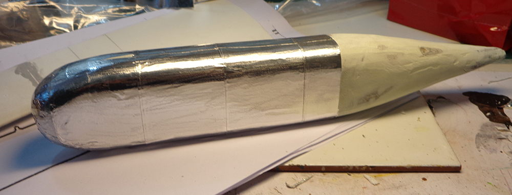

The first aluminum panels have been applied to the fuselage. Looks like a more highend dildo now, doesn't i?
I've layed them on in as large panels as possible, to be able to cut them in to smaller ones later with a scalpel. Rivets will be punched into the panels. Later I will need to take care of the gloss by mimicking oxide, dust and soot.
The end part is sort of ribbed, revealing the framework under the tail. I will replicate this by gluing brass rod onto the maguette and then apply alu-tape on top ot if.
I am quite happy with the result so far. The alu-tape works a treat.
