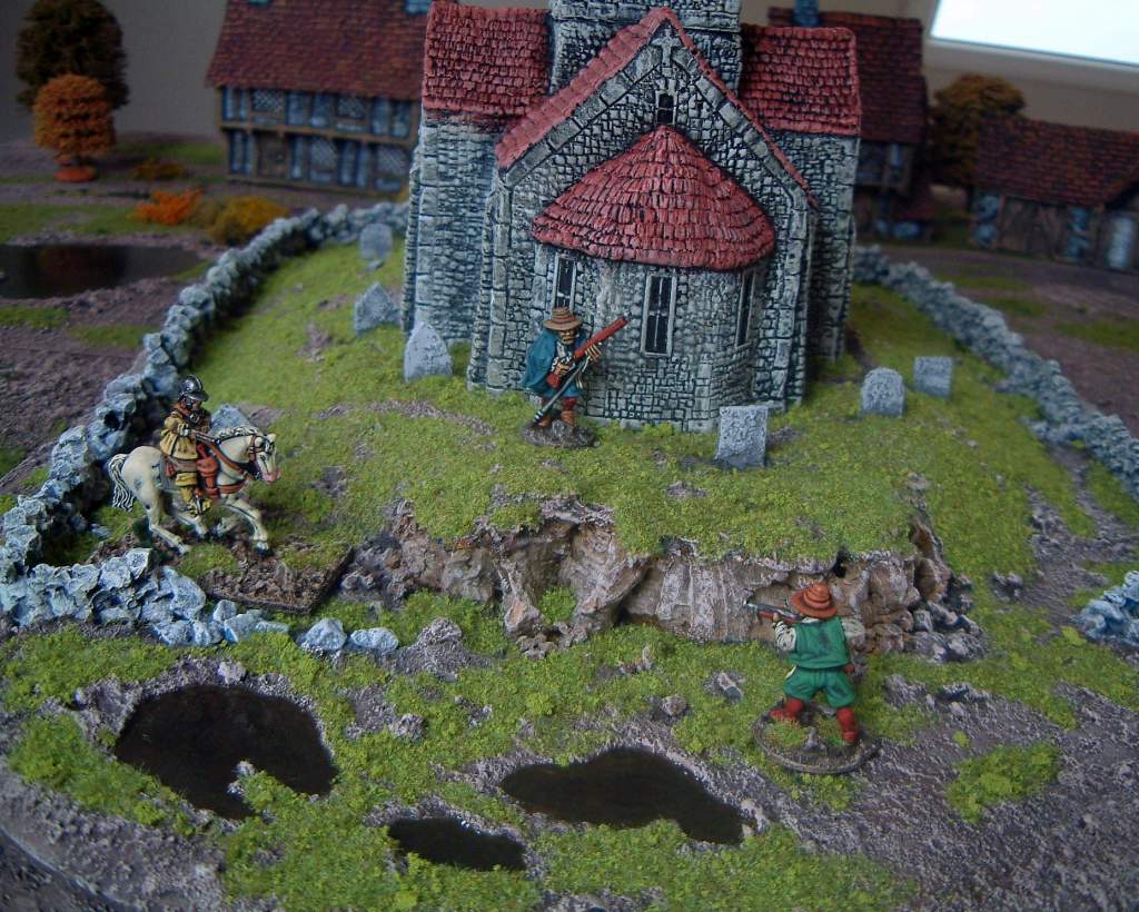

I use Woodland Scenics 'realistic water' - you just pour it on.
It's not cheap, and it's slightly tricky yo use, but generally speaking gives a pretty good effect very easily, especially for ponds and standing pools (as opposed to rivers, which can be a bit more tricky... )

Well - must say I'm surprised by the hostility towards Realistic Water!
I agree it's prone to shrink slightly as it dries - but once you understand its properties its not too hard to work with.
That said, I notice they've just launched a 'new, improved recipe' - so clearly WS acknowledge it wasn't a perfect product.
But I've tried varnish before and that shrinks too, so does PVA... So...  ::)
I don't think any of my water features made using WS Realistic Water has discoloured - but as I tend to use it in a fairly thin layer over a grungily painted base colour, I guess I wouldn't notice even if it did.
I'm about to paint and then 'waterify' about six feet of river - so keep the advice coming. If anyone has a foolproof product, let's hear about it  :)
I've taken the liberty of attaching a few pics of some of the things I've used Realistic Water on. See what you think.
