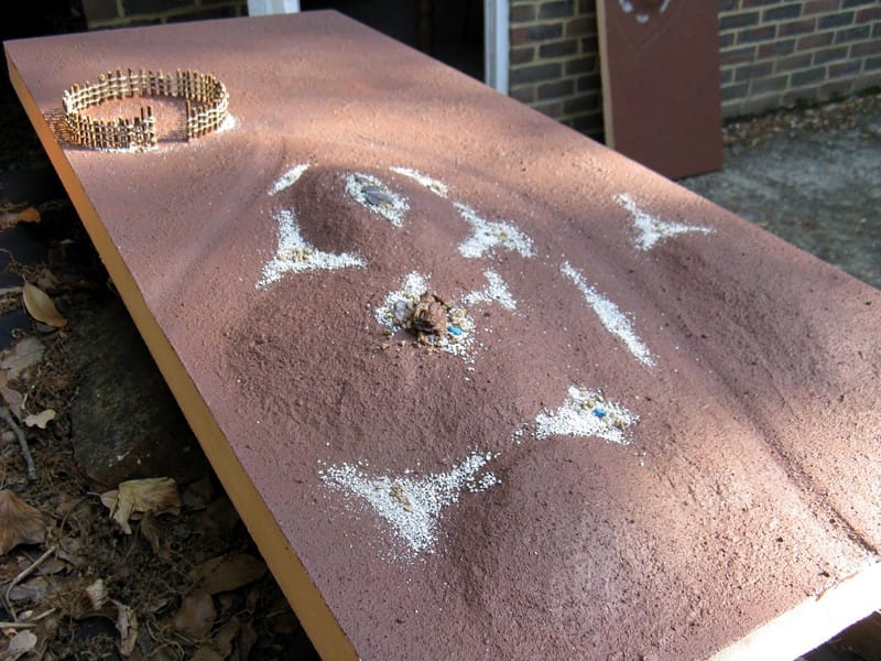

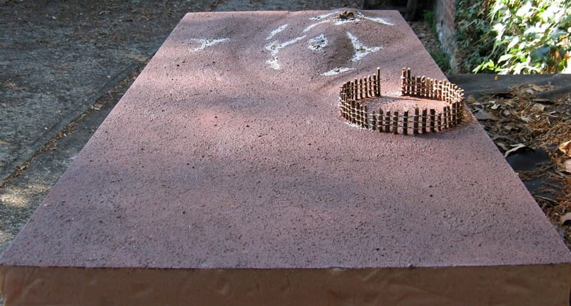

On the fourth (kraal) board, the hills are assembled from foam offcuts, glued into position, sanded to roughly the right shape, and then ‘plastered’ with wall filler.

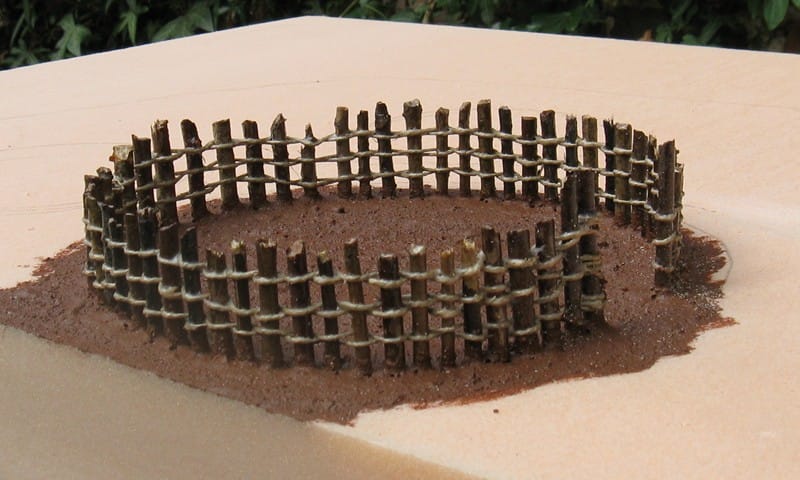

The kraal is ‘woven’ with hemp string, and the whole thing given a saturating coat of PVA to fix everything in position. I was going to basket weave the kraal from the bottom of the stakes to the top, but having looked at various photographs, this style of more open weave fencing seemed just as common.

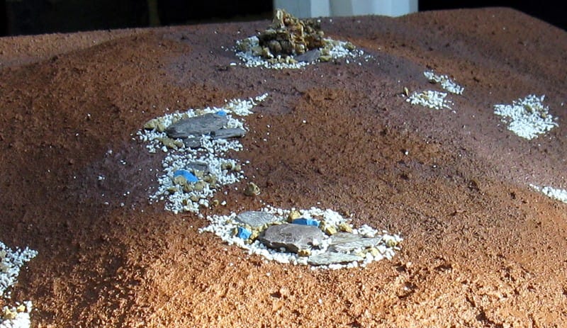

The two 'village end' boards are then finished with a top coat of PVA / sand / paint texture, and various grades of grit and bits of rock added to form small rocky outcrops on top of the hills, and areas of scree around the foot of the slopes...
The edges of the foam slabs are sealed with PVA glue to stop them melting under the paint primer spray.

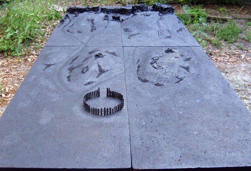

The two boards are then sprayed matt black.
Here then, is the full layout.
That's 8 feet (2.4m) long x 3.5 feet (1m) wide...
There will be native huts around the kraal, and a forest of tambookie grass around the edges of the village - which explains why there is currently a rather flat and featureless area at one end of the board.
The joins between the four boards look rather obvious at this stage. They will look a lot less obvious once painted and weathered, and the vegetation and buildings are on.
Not to mention, once the boards are properly supported on a complete table, rather than all precariously perched on one small table as they are here  ::)

Ingenious use of hemp cord weaving to make the wattle palisade, which idc I shall steal for my Native American village!  ;D

Could you go into a little more detail with the PVA / sand / paint texture please? As in rough quantities and ratios.
Truthfully, it's a bit hard to say, because I just mix it up to what feels about right, adding different amounts of paint and sand as the main ingredients, with a generous helping of PVA into the mix to really bind it together and make sure it dries to an almost plasticised surface.
I suppose roughly, it's one cup sand to two cups of emulsion paint to half a cup of PVA.
If it comes out a bit thin, just add a bit more sand until the mixture 'stiffens up' slightly.
If it's a bit too solid, just add in a little more paint or PVA to make it easier to work with.
You're looking for a fairly wet paste - wet enough to slap on with a paintbrush, but thick enough to cover well.
It's trial and error really.
I use builders sand / sharp sand with most of the bits of grit sieved out, and then a few small bits added back in again to enhance the texture. I think fine sand would make too smooth a paste consistency.
You can see what it looks like when wet in this thread here: http://leadadventureforum.com/index.php?topic=7778.0
