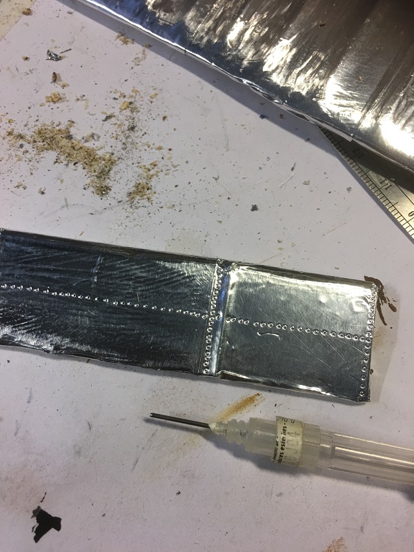

I don't know if anyone remembers this project... It was a while ago since it started but it has over the last week seen some significant progress. For know I just want to show you how very well aluminum tape lends itself to rivet punching.
To get the rivet heads as small as possible I cut the tip of a fine syringe. The rivets are still overscaled and there should be many more lines of them. But I contend myself with punching enough of them to make the whole thing look acceptable.

Indeed. I am going to try it on my steamer. It is so much more difficult to get the rivets right, punching them into styrene. The tape is really easy to cut into panels. It is also quite malleable, meaning you can smooth it over uneven or curved surface.

swiss beading/graving/graining tool is what you need:
Come in sets from stupidly small to >1mm
They do the same job as the syringe without any need for making stuff.
I use them with miliput or greestuff but can also be used on plain plasticard for recessed rivets.
