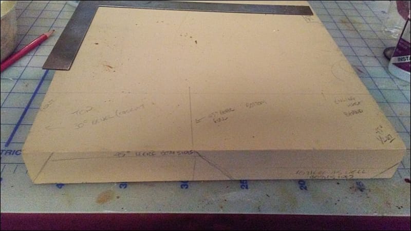

Well, now that I can honestly start...

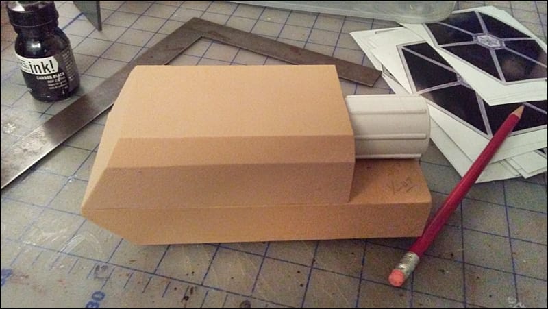

I am going with my favorite go-to material for vehicles and such that I don't feel the need for interiors.  It is 'sign foam', a high-density urethane foam, rated, by pound per cubic foot (this for example, is a 15#, which means it has smaller bubbles and more material than the 10#).
I have a bin of bits off to the side, some sheet styrene, and a box of all of the little odd shaped cutout pieces you get from those wonderful lasercut kits, because I think they will make nice little panels.

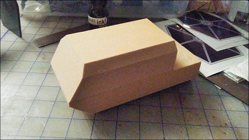

Body work complete!  Now, on to the gribblies and bits.
Main thruster is a piece of PVC piping I found in the garage.

Table saw cuts the material like a charm - took less than 15 mins to get all the angles cut after the pices were done.  Now I am waiting for glue to set...

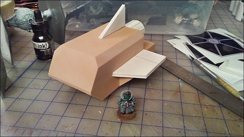

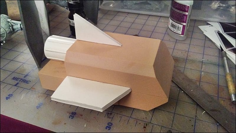

More?  More you say! Well, here you go then.  The benefits to being stuck in the house due to icy road conditions, plus, well, it is bloody cold out there.
I have added wings, a couple of plates and a topfin.
Never mind the TIEs - those are for something completely different.

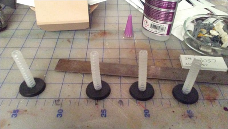

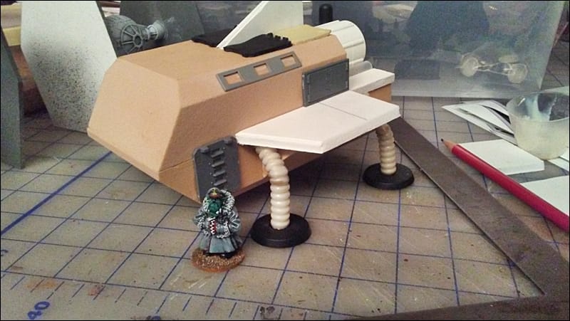

And, so, I was struggling for a little while this morning on what to do for landing gear, because I didn't want just wheels or such - this is a VTOL shuttle, and I needed it look a bit pulpish to give it more flexibility in my gaming.
So I made these:
And put them on like this.
I bent the straw, and filled it with casting resin to keep the curve and give me some surface to attach that was more glue-friendly.  I have since added some green stuff around the joins to the ship, and once that sets, I am back to adding stuff and nonsense.  I may have this thing done today at this rate.

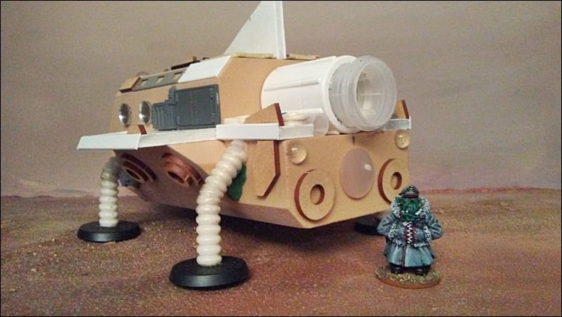

« Reply #11 on: January 09, 2017, 01:33:45 AM »

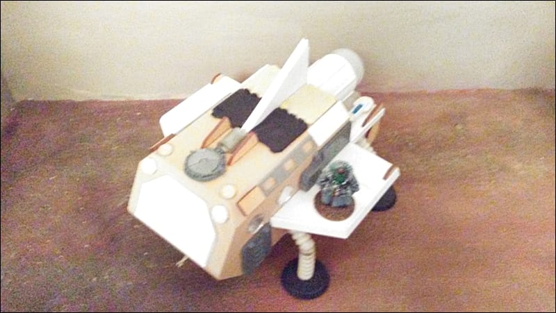

And more work is done!
I love it when everything just seems to talk to you as you work on it.  I am not sure how much more I want to put on before I start painting.

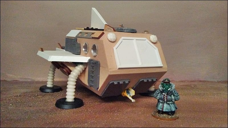

« Reply #13 on: January 09, 2017, 06:20:52 AM »

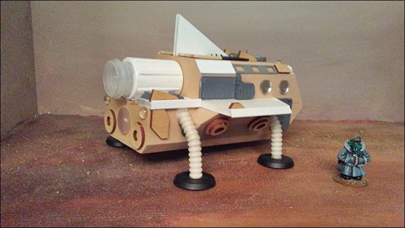

Well, I am finished, I think, except for paint.  I don't know if tjere are records for finishing a Build Something Contest, but here we are.  Simple, not too complex, and flies like a brick.
And, I am spent.  Gotta go to bed and quit binge-watching Finding Bigfoot while I build this.
